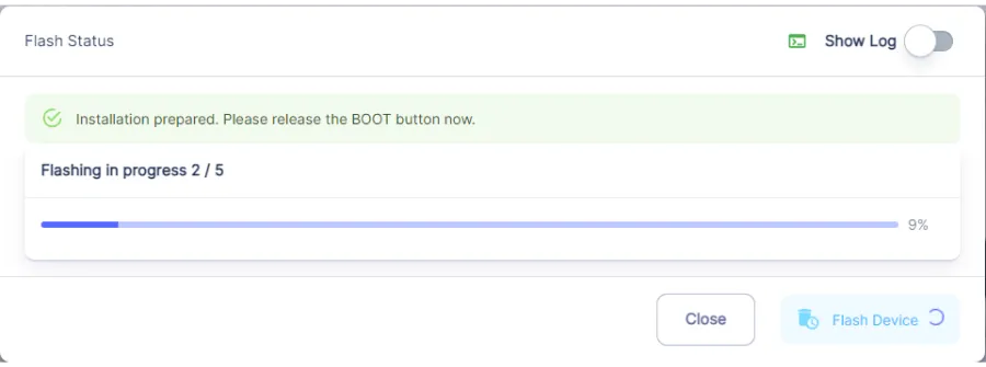

4. Interfacing the LED & Resistor using the EzloPi Web Flasher
Click Connect

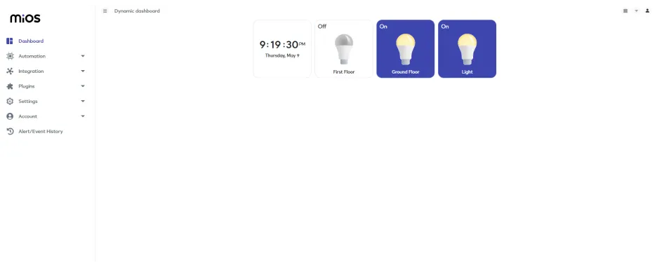

5. MiOS Web Dashboard

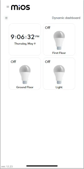

- After opening the MiOS web dashboard, you will be able to see the tile of your connected device. The state of the LED light is controlled by just touching the tile buttons as shown on the app.

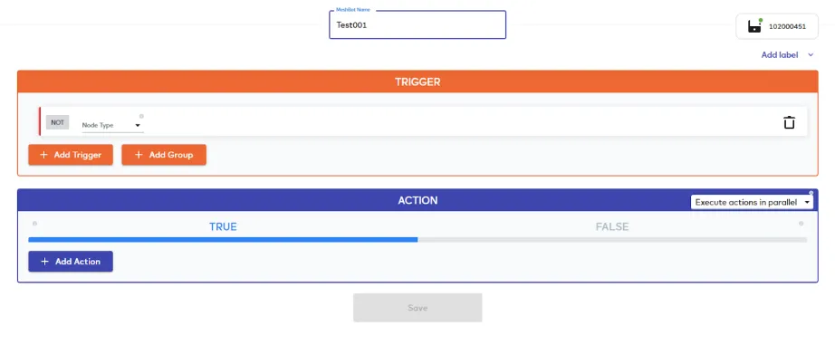

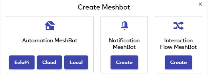

MeshBots:
- On the right side of the screen under Automation, click on MeshBots.
- After clicking on Create new MeshBot you will see new options, now under Automation MeshBot click on Local.
- On the next screen you will see that we can create a name of our choosing, in this case we write it as Test001.
- Set Node Type to Device.
- Set the Node to Ground Floor.
- Set the Category to Switch.
- Set the value to True.
- Add another trigger by clicking Add Trigger.
- Set the Node to First Floor.
- In the True part, Set these values in the ACTION section.
- Set Controllable Type to Device.
- Set the Controllable to Light.
- Set the Capability to Switch.
- Set the Value to true.

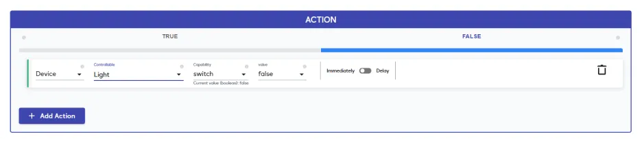

- In the False part, Set these values in the ACTION section.
- Set the Value to false.

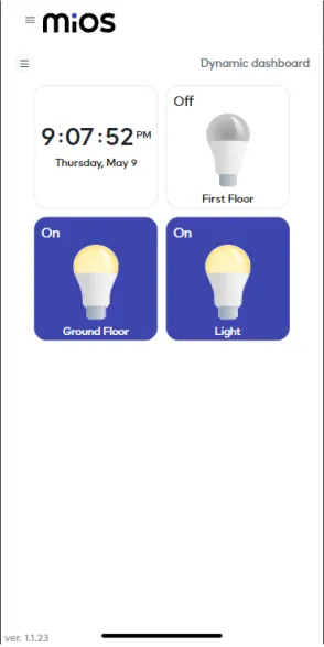

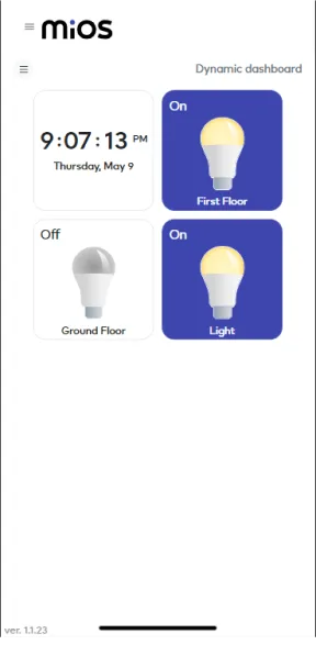

6. MiOS App
- After opening the MiOS mobile app dashboard, you will be able to see the tile of your connected device. The state of the LED Light is controlled by just touching the tile buttons as shown on the app.
- Now, we can see that when the light is operated from the first floor button, the light turns on because of the rule we have set in the meshbot.
- Now, we can see that when the light is operated from the ground floor button, the light turns on because of the rule we have set in the meshbot.

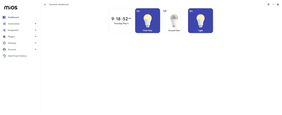

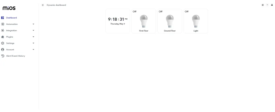

6. MiOS Web Application
- After opening the MiOS mobile app dashboard, We can see that when the Light is operated from the First Floor Button, The Light turns on because of the rule we have set in the meshbot.
- Now, We can see that when the Light is operated from the Ground Floor Button, The Light turns on because of the rule we have set in the meshbot.
