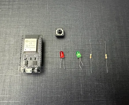

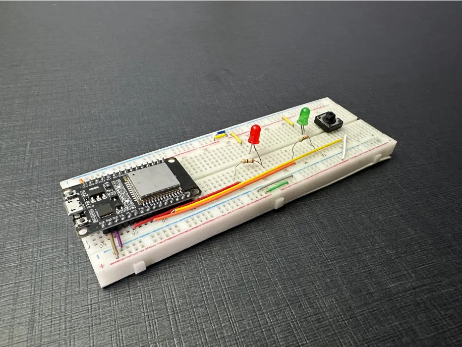

- Push button.
- Two LEDs.
- Two 100 Ohm Resistors.

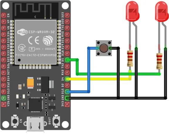

From ESP32 to Push Button:
| ESP32 | SPDT Swtich |
| GND | Terminal No. 1 |
| D15 | Terminal No. 2 |
From ESP32 to Two LEDs & Two Resistors:
| ESP32 | LED 1 | Resistor 1 |
| D4 | Anode | - |
| GND | - | 1st Terminal |
| - | Cathode | 2nd Terminal |
| ESP32 | LED 2 | Resistor 2 |
| D5 | Anode | - |

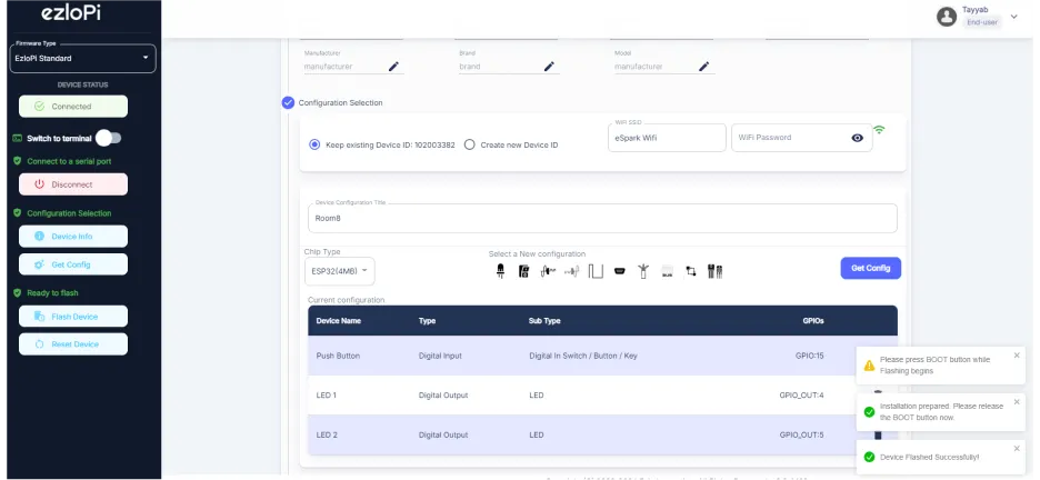

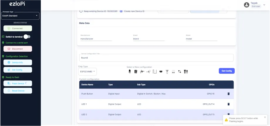

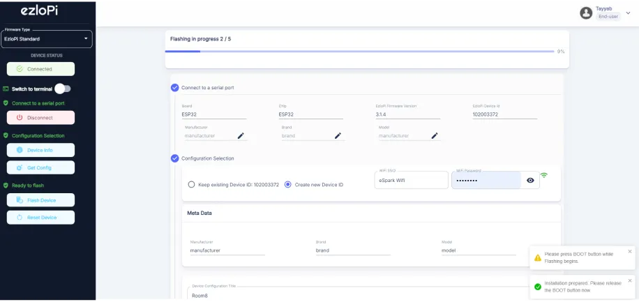

4. Interfacing the Push button with LEDs using the EzloPi Web Flasher
Click Connect

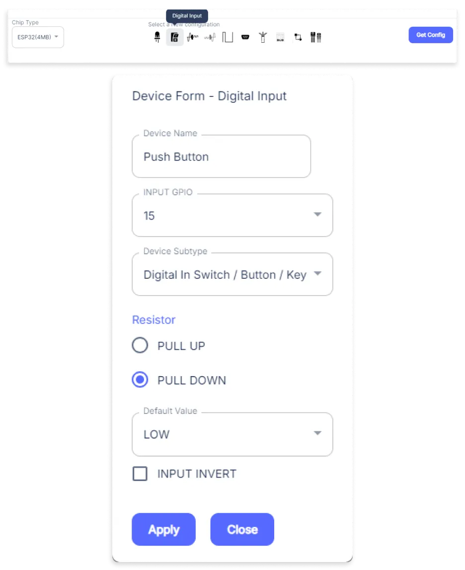

- A Digital Input window will open for inputting the following parameters:
- Set a Device name of your choosing. In our case, we set it to the Push Button.
- Set INPUT GPIO to 15.
- Set Device Subtype to Switch / Button / Key.
- Set Resistor to PULL DOWN.>
- Set the Default Value to LOW.
- Then Click Apply Button.

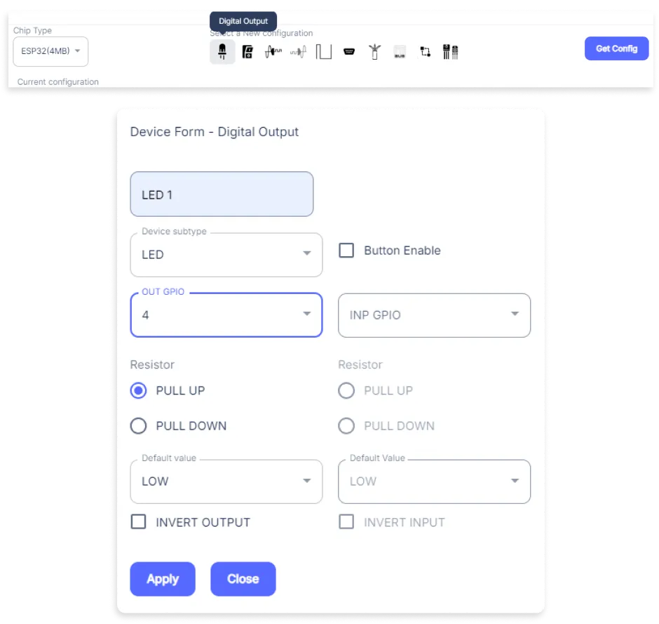

- Set a Device name of your choosing. In our case, we set it to the LED 1.
- Set OUT GPIO to 4.
- Set Device Subtype to LED.
- Set Resistor to PULL UP.
- Again, In the Device Configuration, tab click on Digital Output.
- Set a Device name of your choosing. In our case, we set it to the LED 2.
- Set INPUT GPIO to 5.

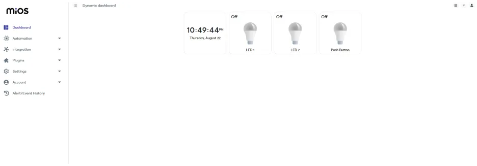

- On the MiOS web dashboard, you will see the tiles of your connected devices as shown labeled as Push Button and the two LEDs named LED 1 and LED 2. Currently, Push Button is not ON or triggered therefore Push Button and both the LEDs tiles show the “OFF” message.

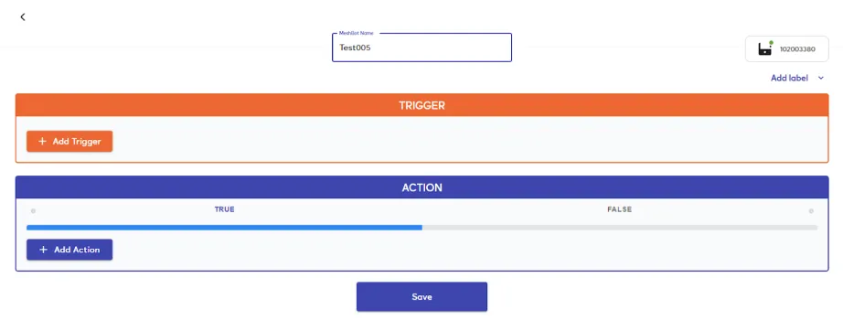

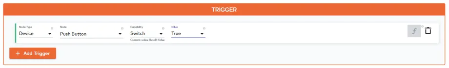

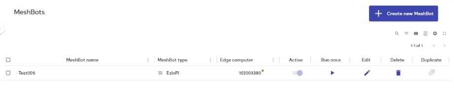

MeshBots:
- After clicking on Create new MeshBot, you will see this now under Automation MeshBot click on EzloPi.
- On the next screen you will see that we can create a name of our choosing, in this case we write it as Test005.
- Set Node Type to Device.
- Set the Node to Push Button.
- Set the Capability to Switch.
- Set the value to True.

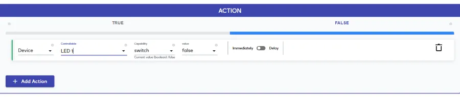

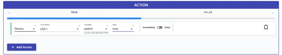

- Set Node type to Device.
- Set Controllable to LED 1.
- Set Capability to switch.
- Set value to true.
- Set value to false.

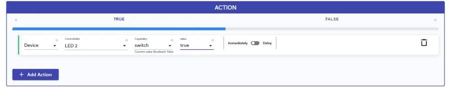

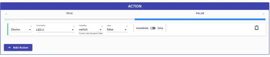

- Set Controllable to LED 2.

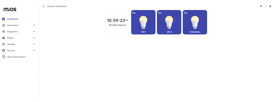

- After clicking the apply button you can see a table of your setting in the Current configuration tab.
- Now as seen above, it shows that when the Push Button is triggered ON, both LEDs get turned ON because of the rules we have set in the meshbot.

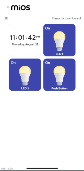

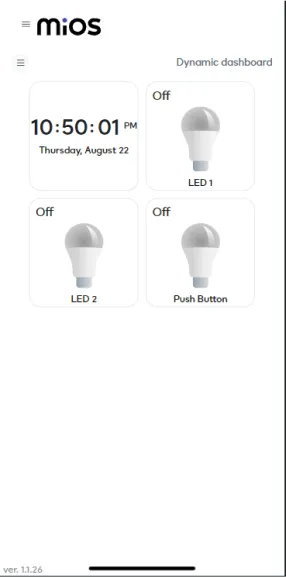

6. MiOS App
- As seen above on the MiOS mobile dashboard, you will see the tiles of your connected devices as shown labeled as Push Button and the two LEDs named LED 1 and LED 2. Currently, Push Button is not ON or triggered therefore Push Button and both the LEDs tiles show the “OFF” message.
