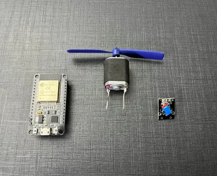

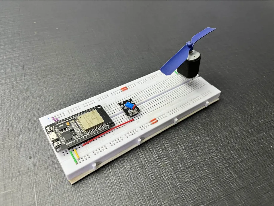

The following project aims to interface the KY-20 tilt switch module with the EzloPi device to detect orientation changes. The KY-20 module is a simple tilt sensor which reacts to tilt movements. The EzloPi device reads the digital signal from the KY-20 module and executes predefined actions which the user has set based on the tilt status. This project setup can be used for applications like motion detection, angle or tilt detection in robotic arms, security systems, and automatic device shutdowns in case of abnormal tilts. The project involves wiring the components, configuring the EzloPi device to interpret the tilt sensor's output, handle the sensor’s data and trigger appropriate responses.
Welcome to the project demonstration video section. The following video showcases the key aspects of Control mini DC motor using Tilt switch, providing a visual walkthrough of its implementation.
- KY-020 Tilt switch module.
- Single Channel Relay Module
- DC Motor
- DC Power Source

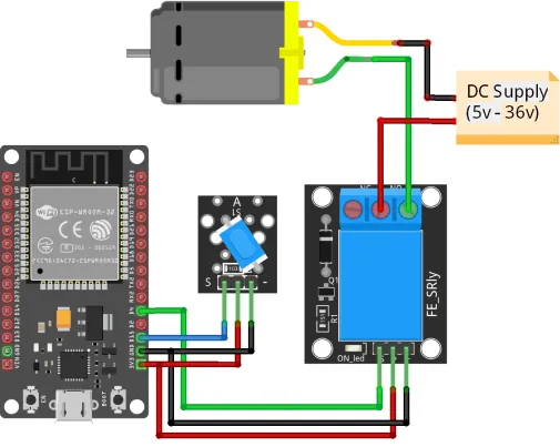

From ESP32 to KY-020:
| ESP32 | KY-020 |
| VCC | Vin |
| GND | GND |
| D15 | S (Signal) |
From ESP32 to the Single Channel Relay module:
| ESP32 | Relay Module |
| 3V3 | (VCC) |
| GND | (GND) |
| D4 | S (Signal) |
From Relay Module to DC Motor & Power Supply:
| Relay Module | Power Supply |
| NO | Positive terminal |
| NC | Negative terminal & 2nd terminal of Motor |
| COM | 1st terminal of Motor |

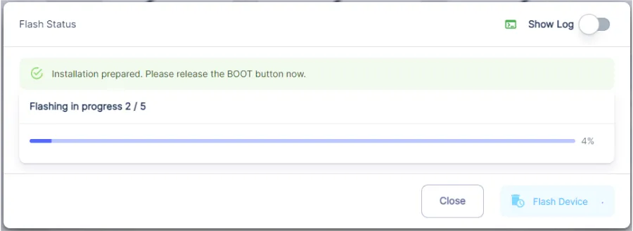

4. Interfacing the Tilt Switch Module & DC Motor using the EzloPi Web Flasher
Click Connect

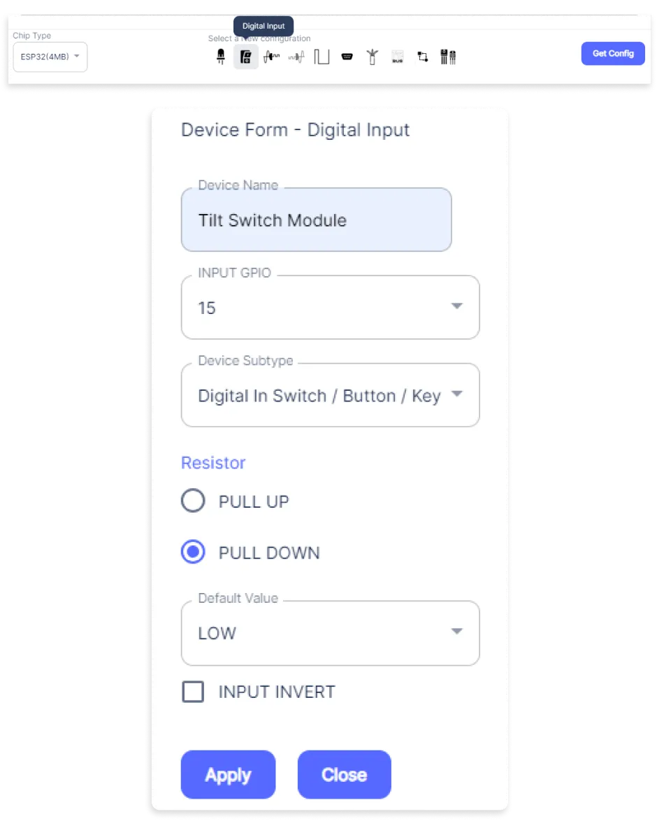

- A Digital Input window will open for inputting the following parameters:
- Set a Device name of your choosing. In our case, we have set it to the Tilt Switch Module.
- Set INPUT GPIO to 15.
- Set Device Subtype to Digital In Switch / Button / Key.
- Set Resistor to PULL DOWN.
- Then Click Apply Button.

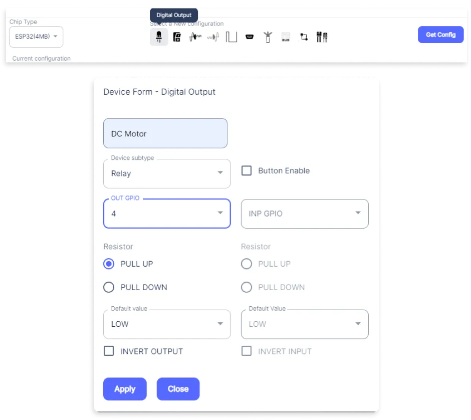

- Set a Device name of your choosing. In our case, we set it to the DC Motor.
- Set INPUT GPIO to 4.
- Set Device Subtype to Relay.
- Set Resistor to PULL UP.

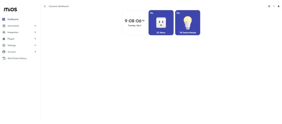

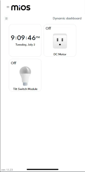

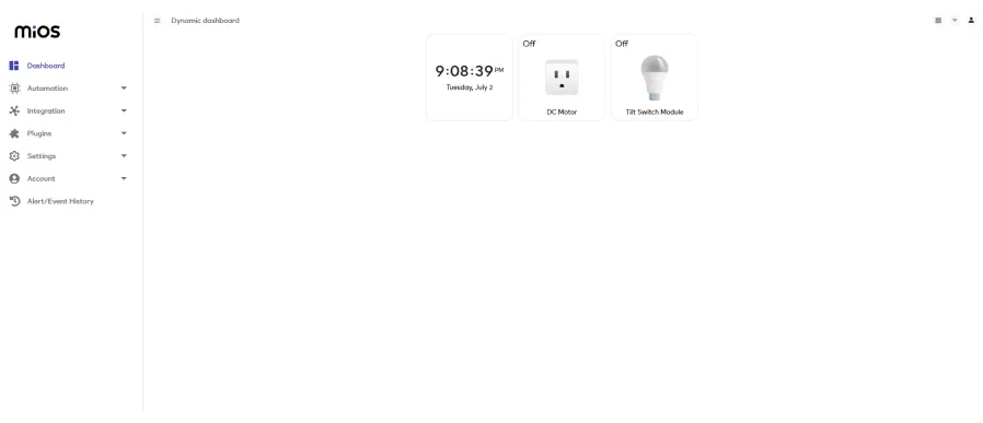

5. MiOS Web Dashboard
- Now, on the MiOS web dashboard, you will see the tiles of your connected devices as shown above labeled as Tilt Switch Module and DC Motor. Currently, no tilting or changes in orientation is detected by the sensor therefore both tilt sensor and DC Motor tiles show the “OFF” message.

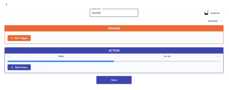

MeshBots:
- After clicking on Create new MeshBot, you will see this now under Automation MeshBot click on EzloPi.
- On the next screen you will see that we can create a name of our choosing, in this case we write it as Test002.

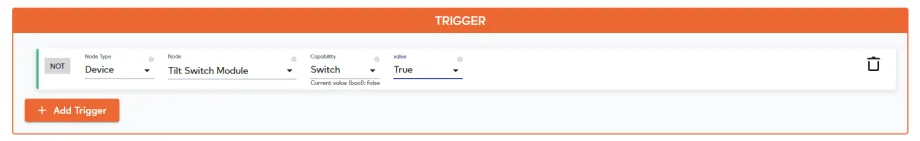

- Set Node Type to Device.
- Set the Node to Tilt Switch Module.
- Set the Capability to Switch.
- Set the value to True.

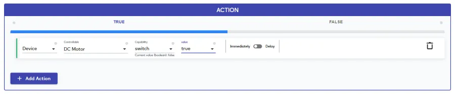

- Set Node type to Device.
- Set Controllable to DC Motor.
- Set Capability to switch.
- Set value to true.

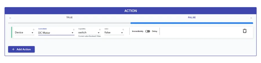

- Set value to false.
- After clicking the apply button you can see a table of your setting in the Current configuration tab.
- Now as seen above, it shows that when the Tilt Switch module gets triggered ON then the DC Motor also gets turned ON because of the rules we have set in the meshbot.

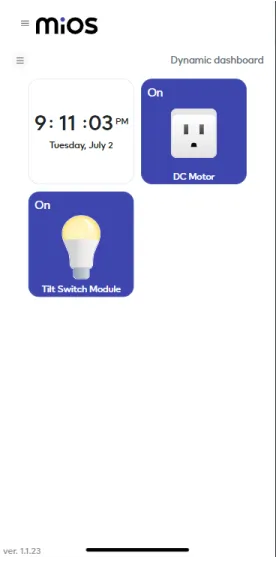

6. MiOS App
- As shown above on the MiOS mobile dashboard, you can see the tiles of your connected devices as shown above labeled as Tilt Switch Module and DC Motor. Currently, no tilting or changes in orientation is detected by the sensor therefore both tilt sensor and DC Motor tiles show the “OFF” message.
