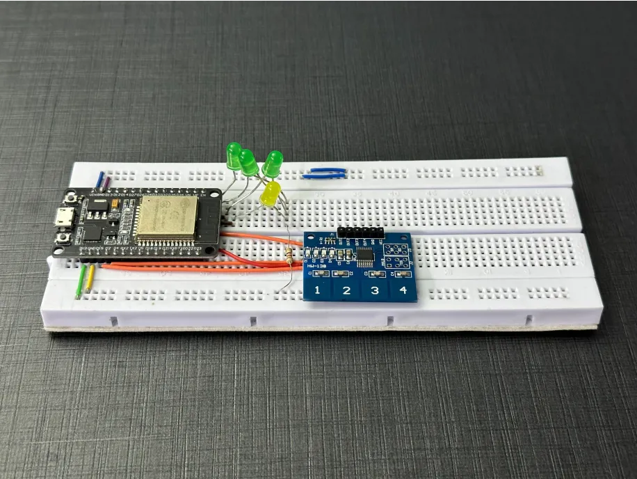

In this project, we have interfaced four different LEDs and a 4-channel touch sensor module TTP224 with the EzloPi device which performs as a four switch module. This will enable users to remotely control the four LEDs using the MiOS smart application along with the touch control to operate the LED’s. This project combines hardware and software components to provide a user-friendly and easy-to-use solution for managing lighting in a smart home environment and ultimately enhancing the user experience and increasing energy efficiency.
Welcome to the project demonstration video section. The following video showcases the key aspects of Control 4 different LEDs' states using touch sensor module TTP224 as switch on EzloPi Platform, providing a visual walkthrough of its implementation.

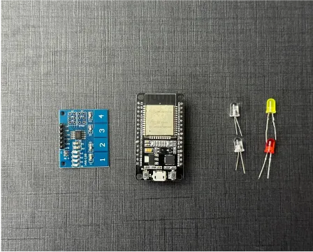

- TTP224 4-channel digital touch sensor.
- 100 Ohms Resistor

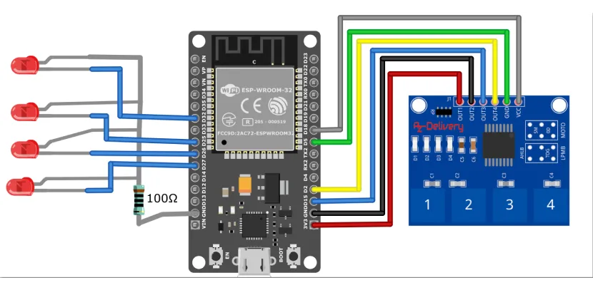

The wiring diagram for ESP32 is represented as below:
The following connections are made in order to complete the entire circuit setup:
From ESP32 to the TTP224 module:
ESP32 | TTP224 |
3V3 | VCC |
GND | GND |
D15 | OUT1 |
D2 | OUT2 |
D5 | OUT3 |
D18 | OUT4 |
From ESP32 to 4 LED’s & Resistor:
ESP32 | LED 01 | LED 02 | LED 03 | LED 04 | Resistor |
D27 | Anode | – | – | – | – |
D26 | – | Anode | – | – | – |
D25 | – | – | Anode | – | – |
D33 | – | – | – | Anode | – |
NA | Cathode | Cathode | Cathode | Cathode | 1st terminal |
GND | – | – | – | – | 2nd terminal |

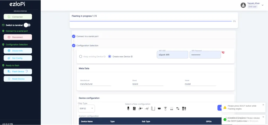

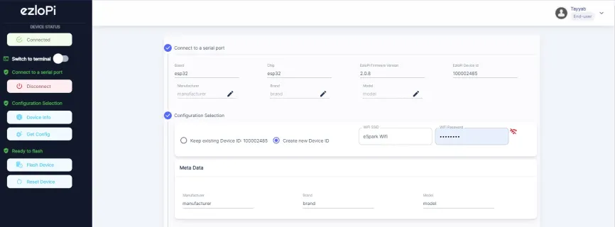

4. Interfacing the TTP224 4-channel Touch sensor module using the EzloPi Web Flasher
Now, select COM Port to which your ESP32 device is connected. In our case, the COM3 port is used.
Click Connect.

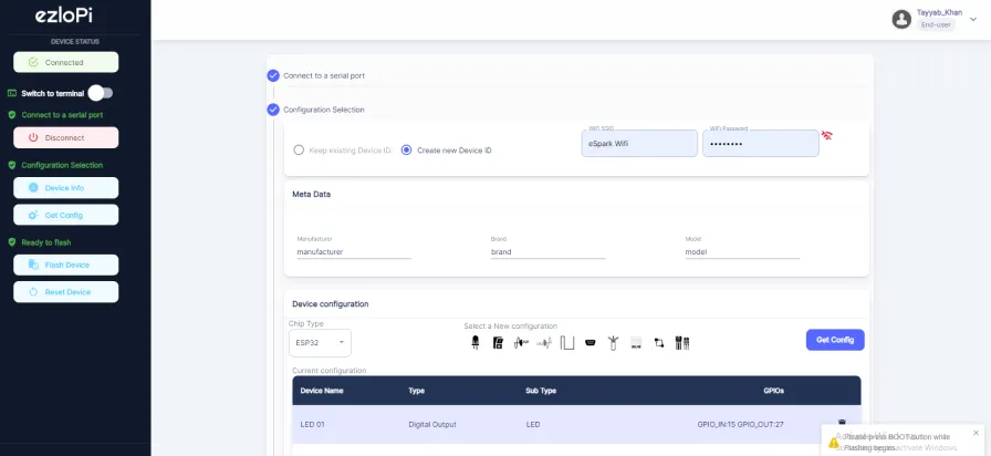

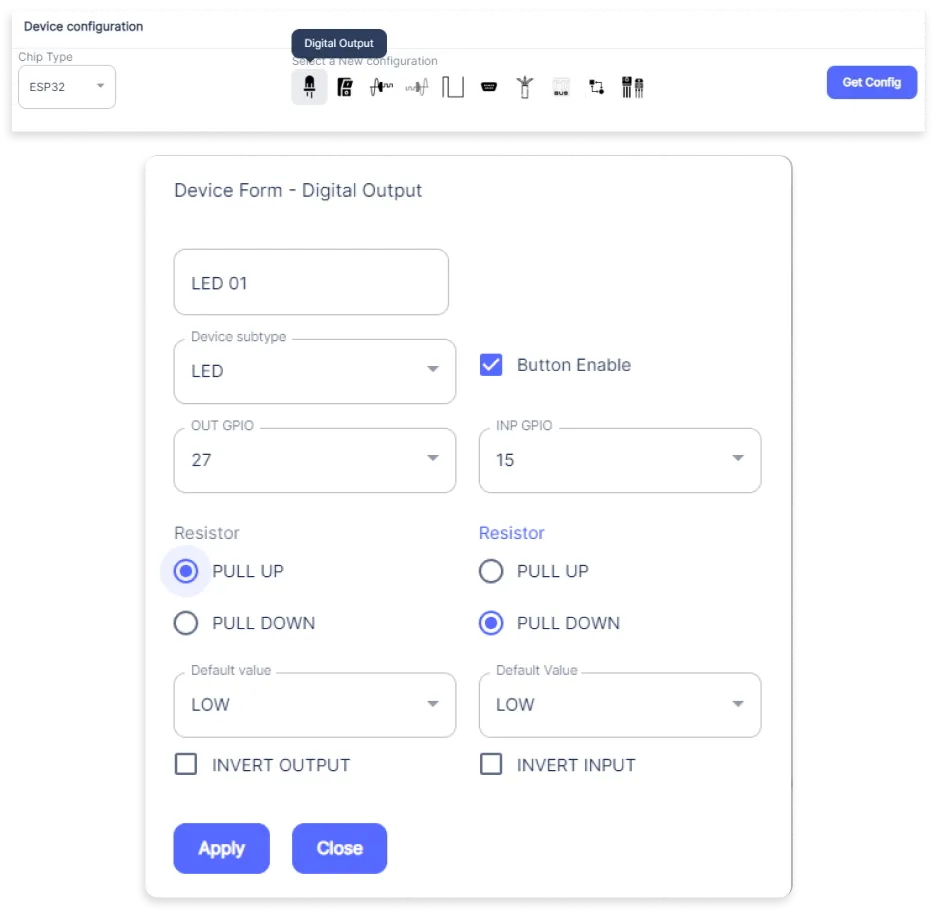

- Set Device name to LED 01.
- Set Device subtype to LED.
- Set OUT GPIO to 27.
- Set Resistor to PULL UP.
- Set the default value to LOW.
- Check the Button Enable box.
- Set INP GPIO to 15.
- Set Resistor to PULL DOWN.

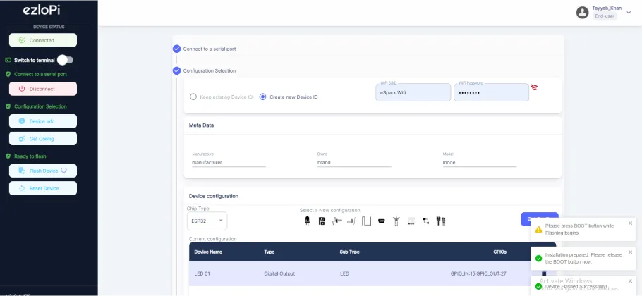

- Then Click Apply Button.

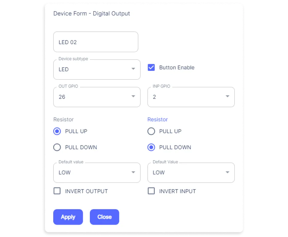

- Set Device name to LED 02.
- Set OUT GPIO to 26.
- Set INP GPIO to 2.

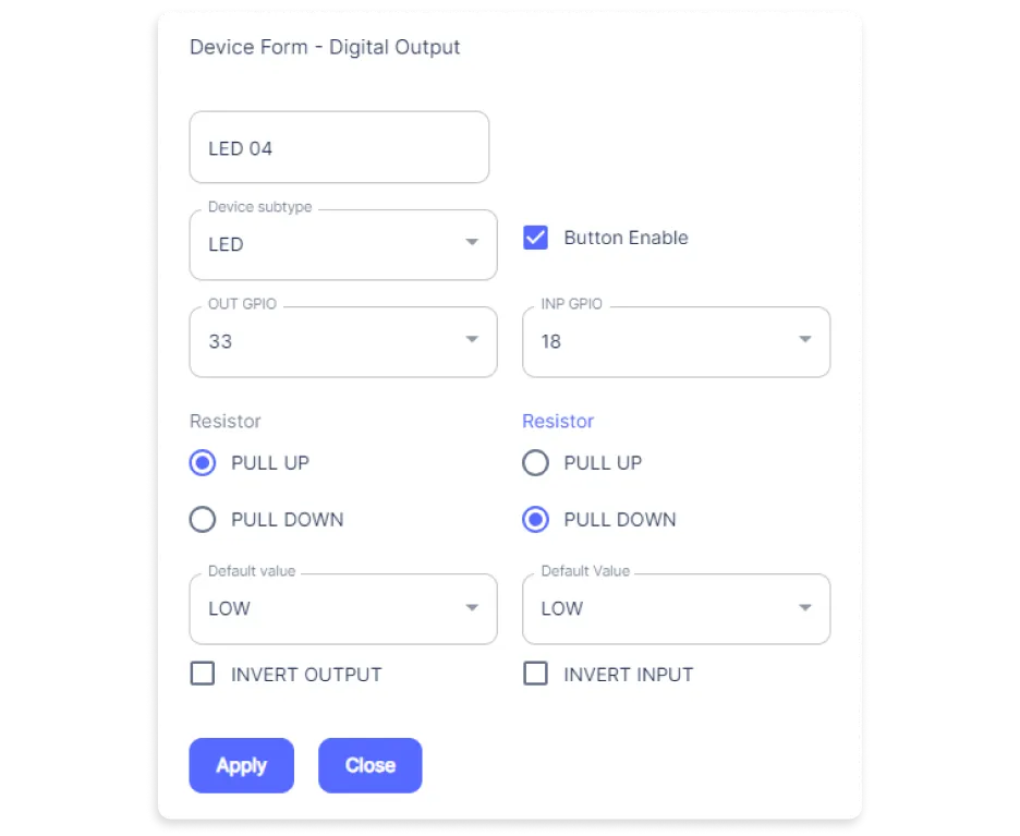

- Set Device name to LED 04.
- Set OUT GPIO to 33.
- Set INP GPIO to 18.

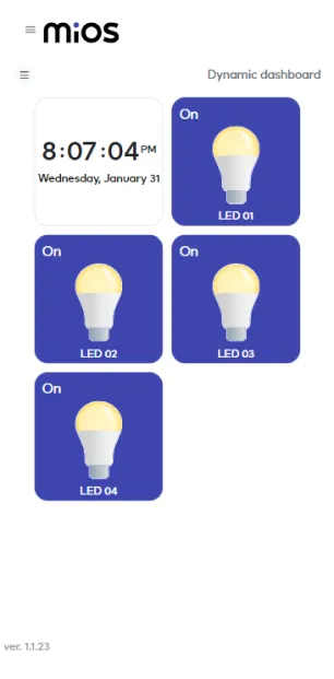

5. MiOS App

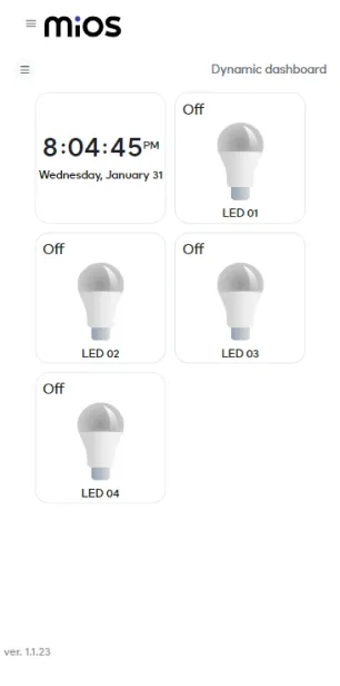

- After opening the MiOS mobile app dashboard, you will be able to see the tile of your connected device. The state of all the four LEDs can be controlled by just touching on the tiles for the LEDs connected to the touch sensor module. Currently, all the tiles for the LEDs are OFF, which indicates that all the LEDs are OFF.
- Similarly, it can be seen that when we touch one by one on the 4-channel touch sensor module, the LEDs turn ON, also the tiles indicate that all four LEDs have turned ON.

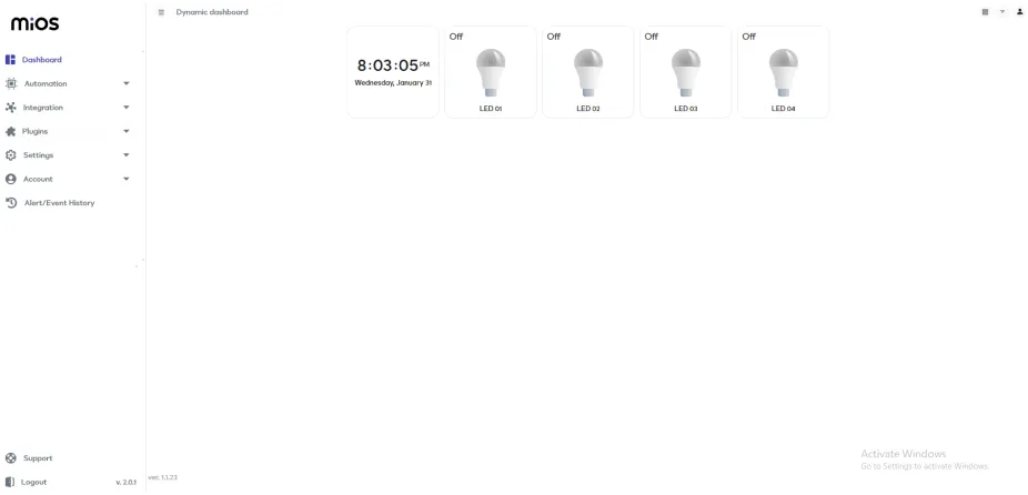

6. MiOS Web Application

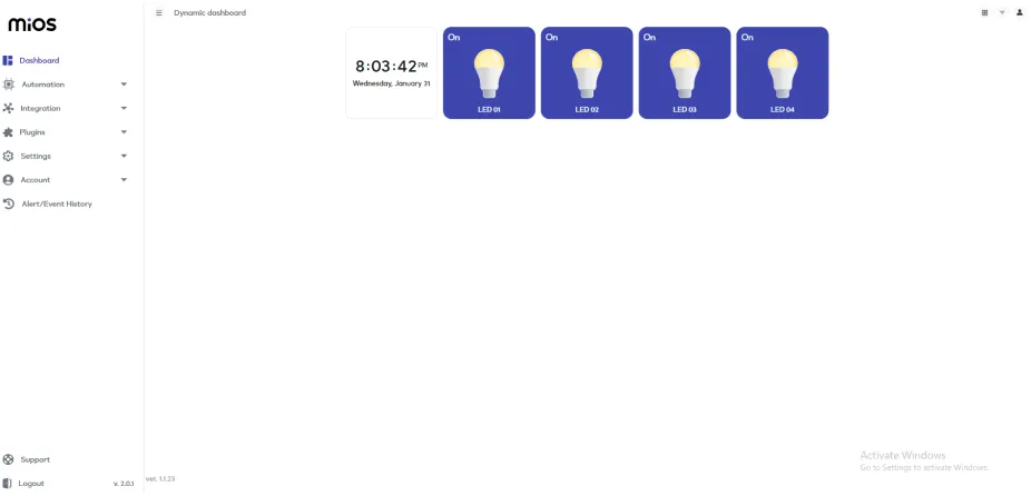

- After opening the MiOS web dashboard, you will be able to see the tile of your connected device. The state of all the four LEDs can be controlled by just touching on the tiles for the LEDs connected to the touch sensor module. Currently, all the tiles for the LEDs are OFF, which indicates that all the LEDs are OFF.
