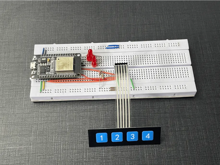

- 1x4 Membrane matrix keypad.
- 4x LEDs.
- 100 Ohms resistor.

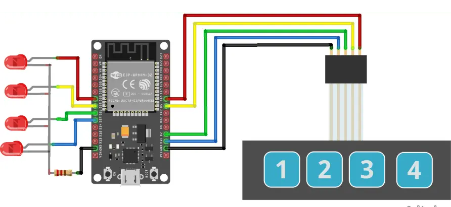

From ESP32 to the TTP224 module:
| ESP32 | 1x4 Membrane Matrix Keypad |
| GND | Pin 5 (Common) |
| D15 | Pin 4 |
| D2 | Pin 3 |
| D5 | Pin 2 |
| D18 | Pin 1 |
| ESP32 | LED 01 | LED 02 | LED 03 | LED 04 | Resistor |
| D27 | Anode | - | - | - | - |
| D26 | - | Anode | - | - | - |
| D25 | - | - | Anode | - | - |
| D33 | - | - | - | Anode | - |
| NA | Cathode | Cathode | Cathode | Cathode | 1st Terminal |
| GND | - | - | - | - | 2nd Terminal |

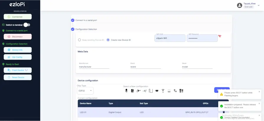

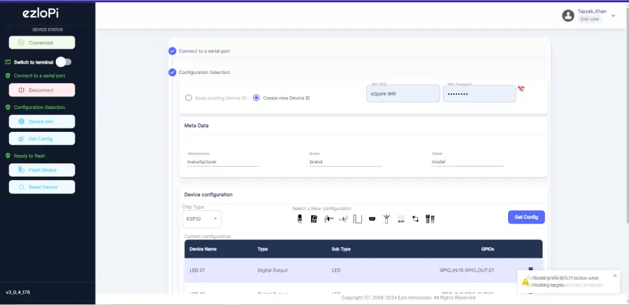

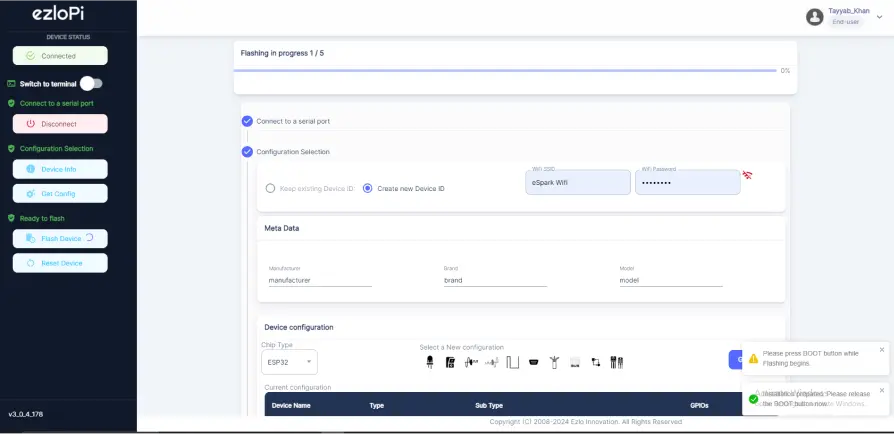

4. Interfacing the 1x4 Membrane Matrix Keypad using the EzloPi Web Flasher
Click Connect
- If you are new to this and it's your first time configuring, select Create new Device ID. Click on the Configure Wifi button. Enter Wifi SSID and Wifi Password.
- Set Device name to LED 01.
- Set Device subtype to LED.
- Set OUT GPIO to 27.
- Set Resistor to PULL UP.
- Set the default value to LOW.
- Check the Button Enable box.
- Set INP GPIO to 15.
- Set Resistor to PULL DOWN.
- Then Click Apply Button.

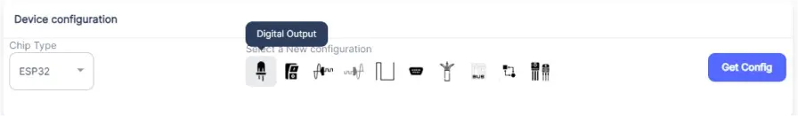

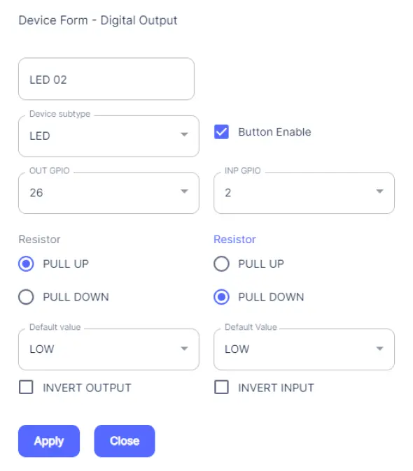

- Again, In the Device Configuration, tab click on Digital Output.
- Set Device name to LED 02.
- Set OUT GPIO to 26.
- Set INP GPIO to 2.

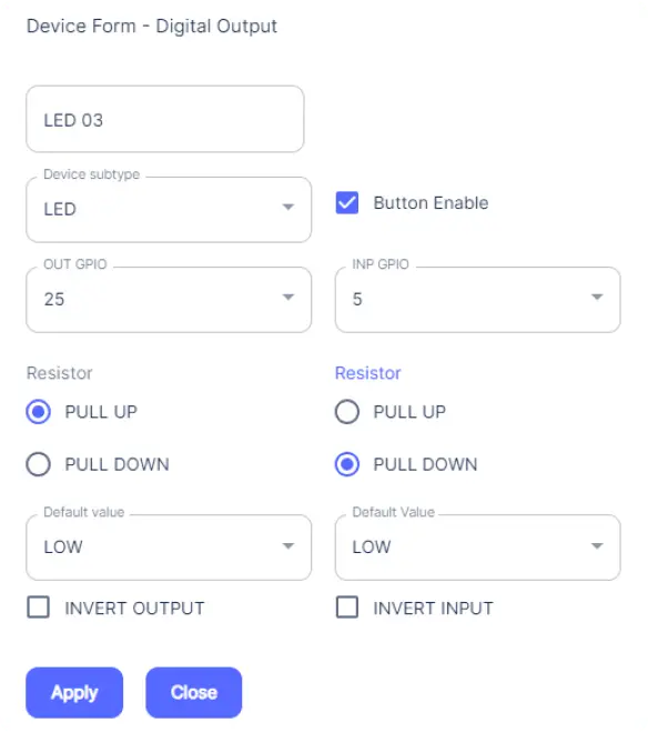

- Set Device name to LED 03.
- Set OUT GPIO to 25.
- Set INP GPIO to 5.

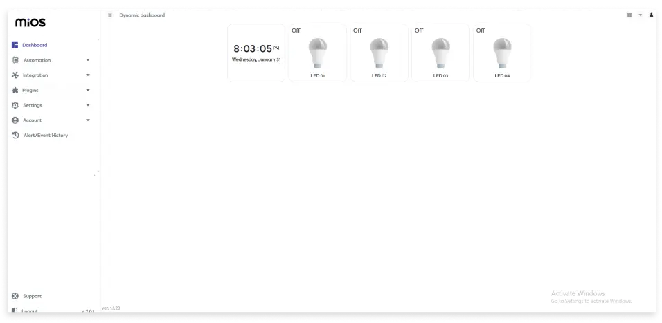

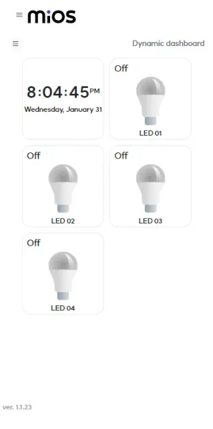

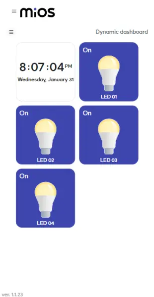

5. MiOS App
- After opening the MiOS mobile dashboard, you will be able to see the tile of your connected device. The state of all the four LEDs can be controlled by just pressing on the 1x4 matrix keypad. Currently, all the tiles for the LEDs are OFF, which indicates that all the LEDs are OFF.
- Similarly, it can be seen that when we press one by one on the keypad, the LEDs turn ON, also the tiles indicate that all four LEDs have turned ON.

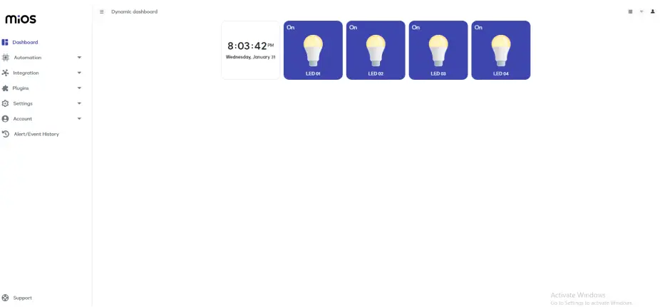

6. MiOS Web Dashboard
- After opening the MiOS web dashboard, you will be able to see the tile of your connected device. The state of all the four LEDs can be controlled by just pressing on the 1x4 matrix keypad. Currently, all the tiles for the LEDs are OFF, which indicates that all the LEDs are OFF.
