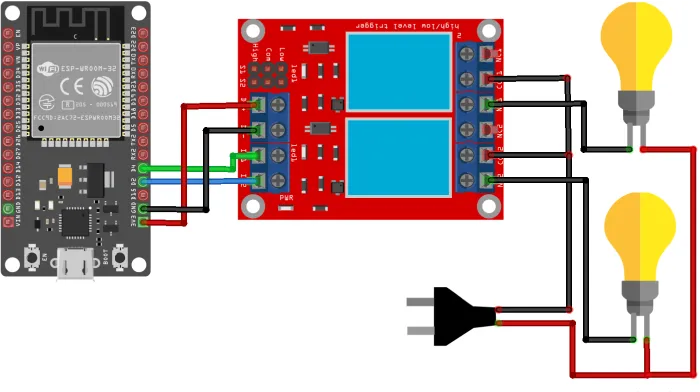

The wiring diagram is represented as follows:
The following connections are made in order to complete the entire circuit setup:
From ESP32 to the Relay module:
- Connect the D4 pin from the ESP32 to the 1st channel of the relay module.
- Connect the D2 pin from the ESP32 to the 2nd channel of the relay module.
- Connect the GND from the ESP32 to the GND of the relay module.
- Connect ‘+’ terminal to 3V3.
From Relay module to 220V AC Lamps:
- Connect the common of the relay module to the neutral.
- Connect the normally open point to the NO1 terminal of the 1st bulb and NO2 of the 2nd bulb and the second point of the bulbs will be connected to phase voltages.

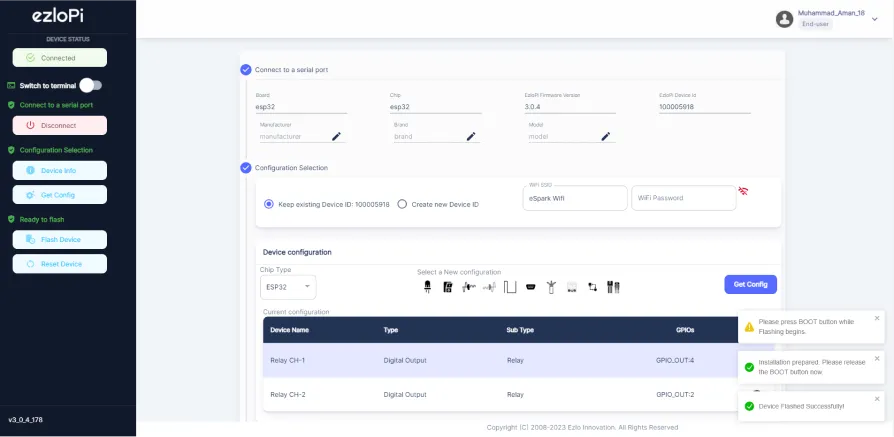

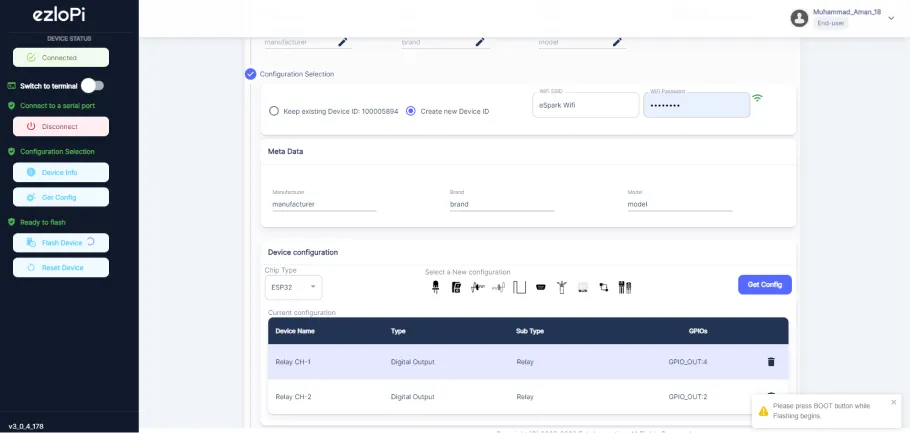

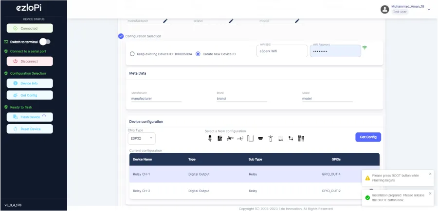

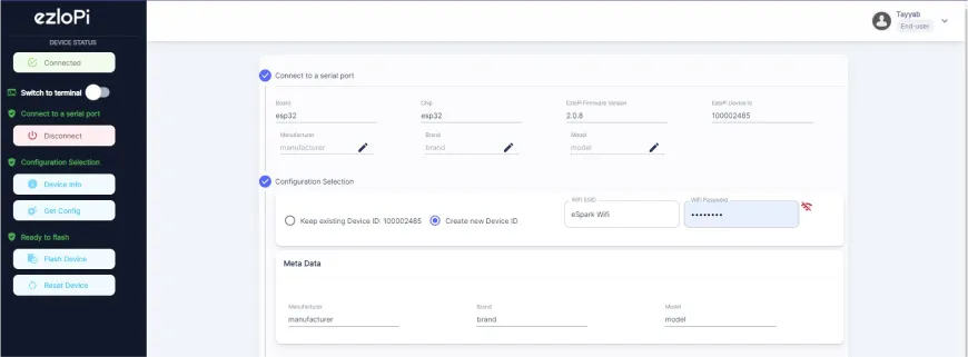

3. Interfacing the 2-Channel Relay module using the EzloPi Web Flasher
Now, select COM Port to which your ESP32 device is connected. In our case, the COM3 port is used.
Click Connect.

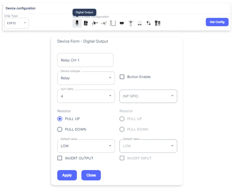

- A window will open for inputting the following parameters:
- Set a device name of your choosing. In our case, we set it to Relay CH-2
- Set Device subtype to Relay.
- Set OUT GPIO to 2.
- Set Resistor to PULL UP.
- Set the default value to LOW.
- Now Click the Apply button.

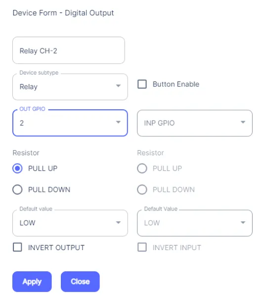

- Again click on the Digital output button for interfacing the second relay.

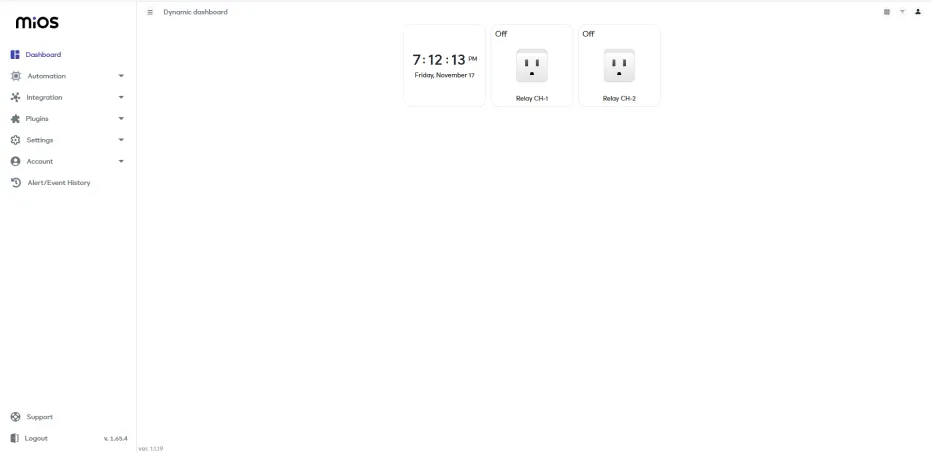

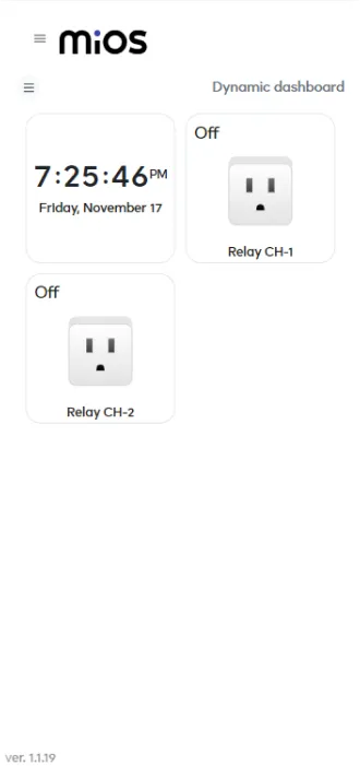

5. MiOS App
- After opening the MiOS mobile app dashboard, you will be able to see the tile of your connected device. The state of the 2-channel relay module is controlled by just touching the tile button as shown on the app.
6. MiOS Web Application
- After opening the MiOS web dashboard, you will be able to see the tile of your connected device. The state of the 2-channel relay module is controlled by just touching the tile button as shown on the web dashboard.
