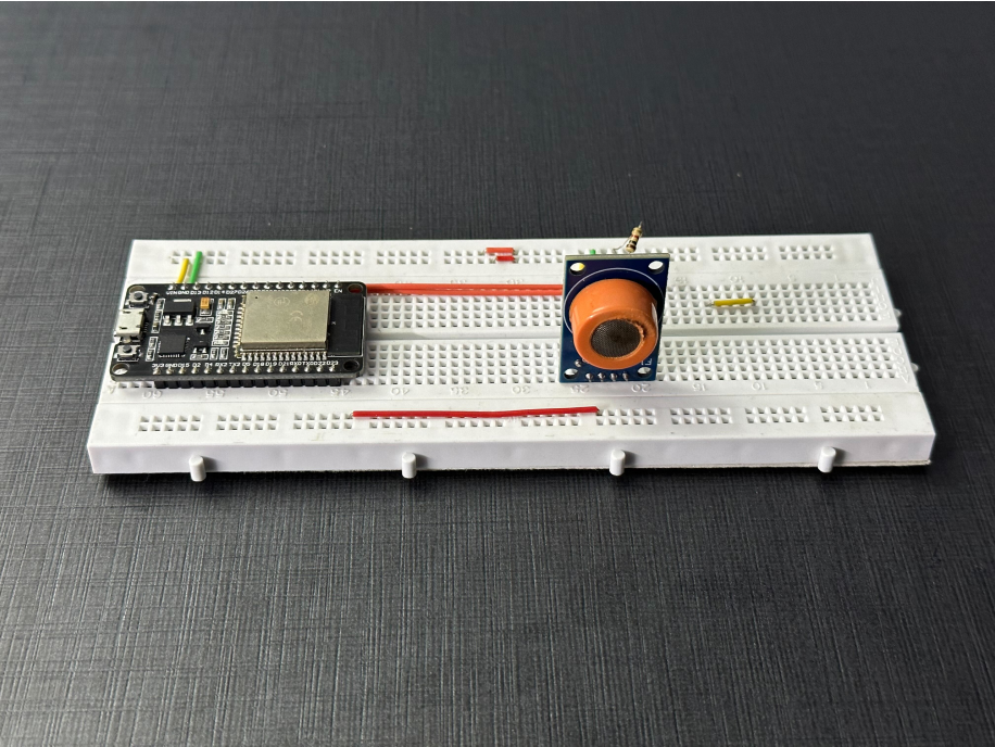

- MQ-9 LPG combustible gas sensor.

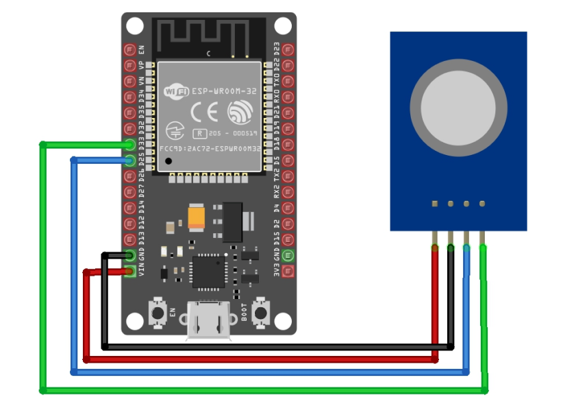

The wiring diagram for the ESP32 30 pin is represented as below:
From ESP32 to the MQ9 Combustible Gas Sensor:

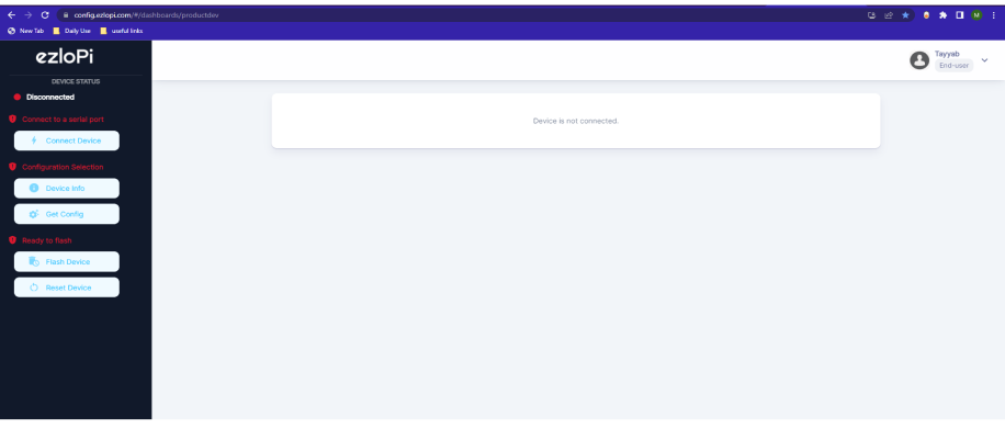

Set up your device/hardware by visiting config.ezlopi.com
Now, select COM Port to which your ESP32 device is connected. In our case, the COM3 port is used.
Click Connect.
- In the Device Configuration, tab click on Other.
- A window will open for inputting the following parameters:
- Set a device name of your choosing. In our case, we set it to MQ9.
- Set Device subtype to MQ9 LPG Flammable Gas Sensor.
- Check the box of GPIO 1.
- Set GPIO 1 to 25.
- Check the box of GPIO 2.
- Set GPIO 2 to 33.
- Then Click Apply Button.

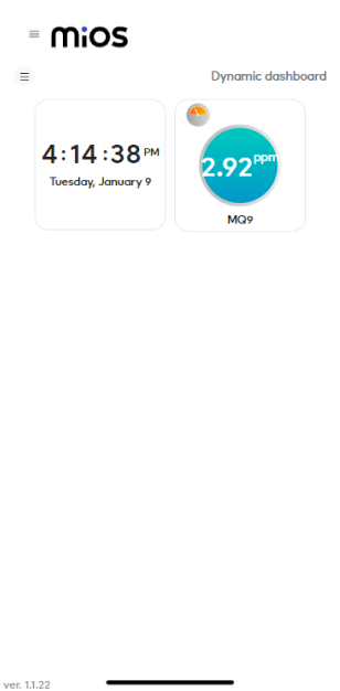

4. MiOS App
- After opening the MiOS mobile dashboard, you see the tile of your connected device. The MQ9 tile will reflect the concentration readings of the LPG gas as shown above.

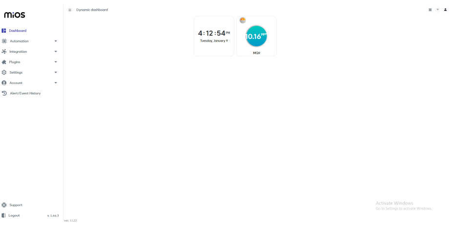

5. MiOS Web Application
- After opening the MiOS web dashboard, you see the tile of your connected device. The MQ9 tile will reflect the concentration readings of the LPG gas as shown above.
