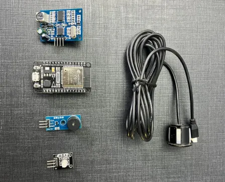

This project aims to develop a collision avoidance system for marine navigation using the JSN-SR04T ultrasonic sensor and a buzzer, interfaced with the EzloPi device. The project continuously monitors the distance to obstacles in the water by emitting ultrasonic waves and measuring their echo. If the distance falls below a set threshold, the buzzer is triggered to alert the crew, allowing timely evasive actions. The JSN-SR04T’s waterproof design makes it ideal for harsh marine environments, while the EzloPi device provides real-time monitoring, ensuring efficient operation and enhancing navigation safety.
Welcome to the project demonstration video section. The following video showcases the key aspects of Collision avoidance system in marine navigation, providing a visual walkthrough of its implementation.

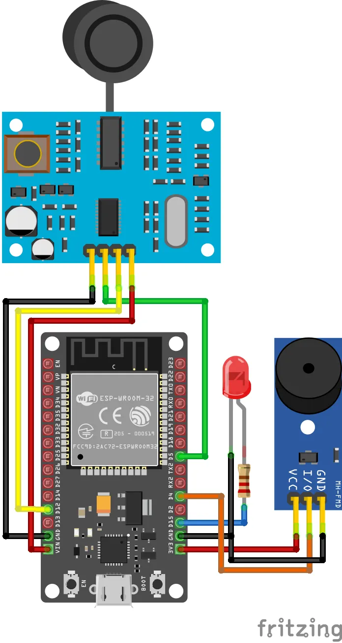

- JSN-SR04T Ultrasonic sensor with analog to digital interface module.
- LED with 120 Ohm resistor
- MH-FMD Buzzer

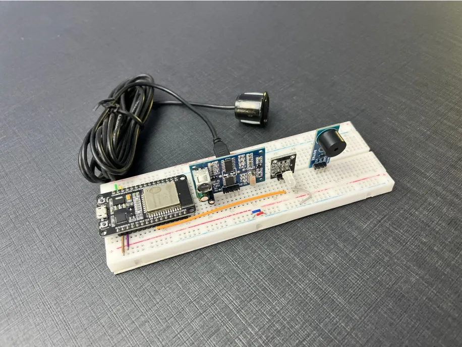

From ESP32 to the JSN SR04T:
| ESP32 | JSN SR04T |
| VIN | VIN |
| GND | GND |
| D5 | ECHO PIN |
| D12 | TRIG PIN |
From ESP32 to the LED & Resistor:
| ESP32 | LED | Resistor |
| D15 | - | Terminal 1 |
| GND | Cathode | - |
| - | Anode | Terminal 2 |
From ESP32 to the Buzzer:
| ESP32 | Buzzer |
| 3V3 | VCC |
| GND | GND |
| D4 | I/O |

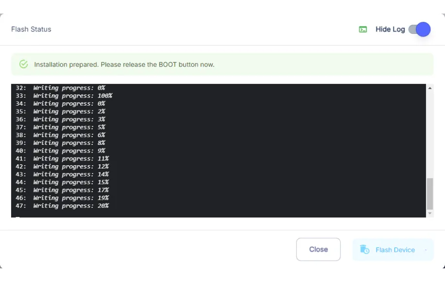

4. Interfacing the Ultrasonic sensor, LED & Buzzer with the EzloPi Web Flasher:
Click Connect

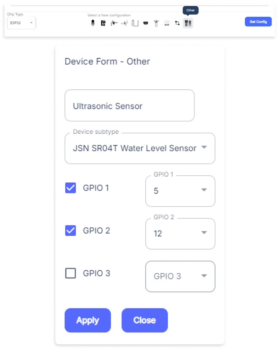

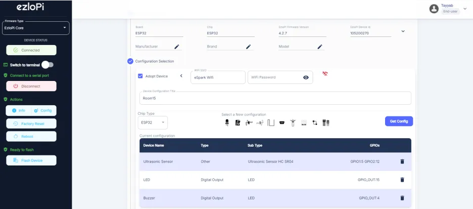

- In the Device Configuration, tab click on Other.
- An Other Input window will open for inputting the following parameters:
- Set a Device name of your choosing. In our case, we set it to Ultrasonic Sensor.
- Set Device Subtype to JSN SR04T Water Level Sensor.
- Tick mark the box of GPIO1 and Set the GPIO1 to 5.
- Tick mark the box of GPIO2 and Set the GPIO2 to 12.
- Then Click Apply Button.

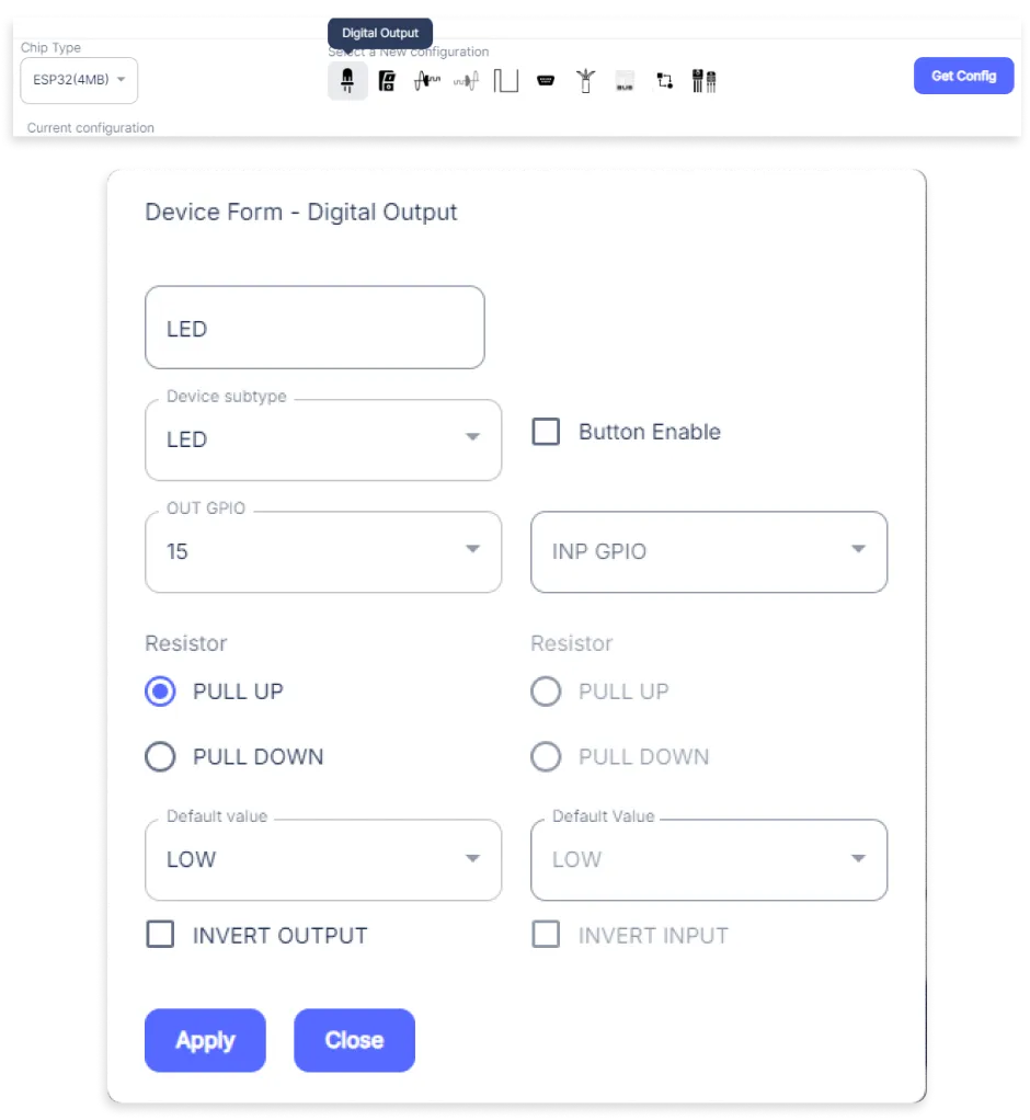

- Set a Device name of your choosing. In our case, we set it to the LED.
- Set Device Subtype to LED.
- Set the OUT GPIO to 15.
- Set the Resistor to PULL UP.
- In the Device Configuration, tab click on Digital Output
- Set a Device name of your choosing. In our case, we set it to the Buzzer.
- Set the OUT GPIO to 4.

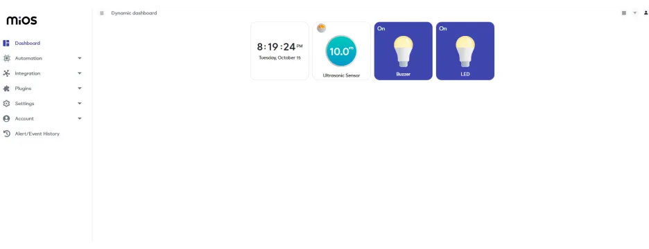

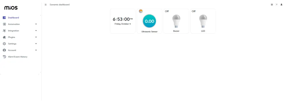

5. MiOS Web Dashboard
- Here, on the MiOS web dashboard, you will be able to see the tiles of connected devices. In our case we have a JSN-SR04T ultrasonic sensor, LED and buzzer tiles. The LED and buzzer tiles will indicate the distance from the object in the water detected by the JSN-SR04T sensor.

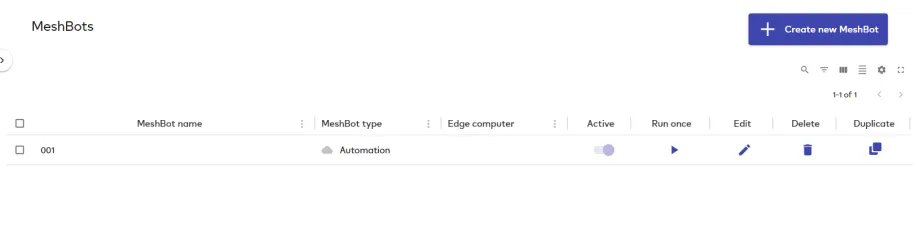

MeshBots:

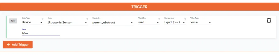

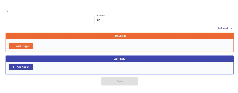

- After clicking on Create new MeshBot, you will see this now under Automation MeshBot click on Cloud.
- On the next screen you will see that we can create a name of our choosing, in this case we write it as 001.
- Set Node Type to Device.
- Set the Node to Ultrasonic Sensor.
- Set the Capability to parent_abstract.
- Set the variables to uuid.
- Set the Comparator to Equal (==).
- Set the Value Type to value.
- Set the value to 20m.
- Set Controllable Type to Device.
- Set the Controllable to LED.
- Set the Capability to power_command.
- Set the Value Type to set.
- Set the value to true.

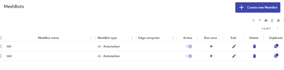

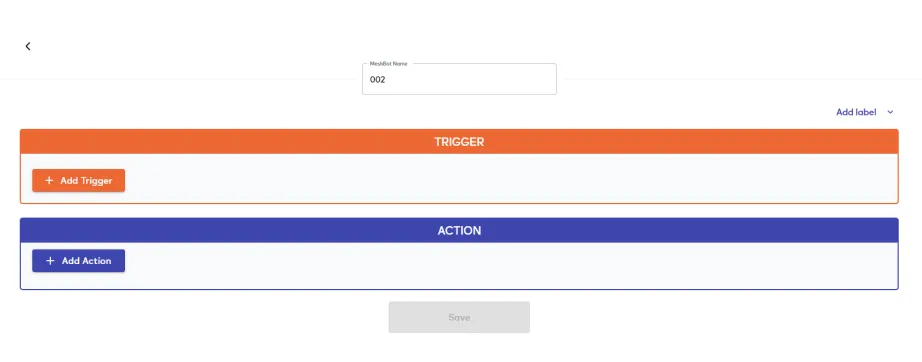

- Here you can see your saved MeshBot. Now again on Create new Meshbot.

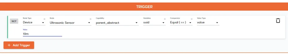

- On the next screen you will see that we can create a name of our choosing, in this case we write it as 002.
- Set the value to 10m.

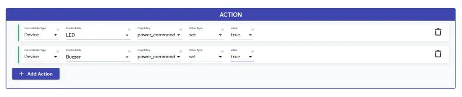

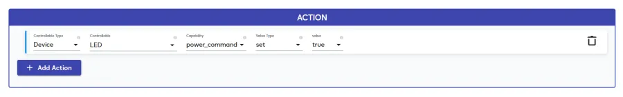

- Add another action by clicking the Add Action button.
- Set the Controllable to Buzzer.

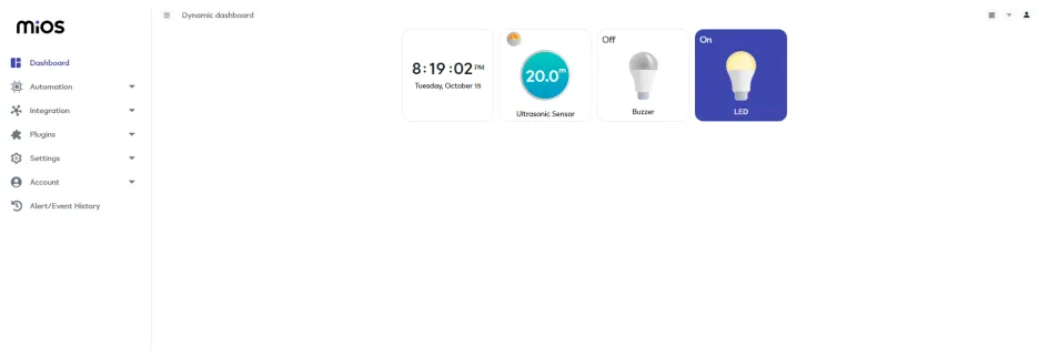

- Now in the MiOS web dashboard, we can see that when the distance reaches a certain value which is 20 meters, then the LED turns ON for the first alert about the nearing object because of the rules we have set in meshbot.
- Here in the above picture, we can see that when the distance reaches a value of 10 meters, then the LED and buzzer both turn ON to fully alert to avoid hitting the object because of our meshbot settings.

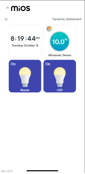

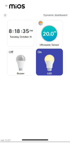

6. MiOS App
- Now as seen on the MiOS mobile dashboard, we can see that when the distance reaches a certain value which is 20 meters, then the LED turns ON for the first alert about the nearing object because of the rules we have set in meshbot.
