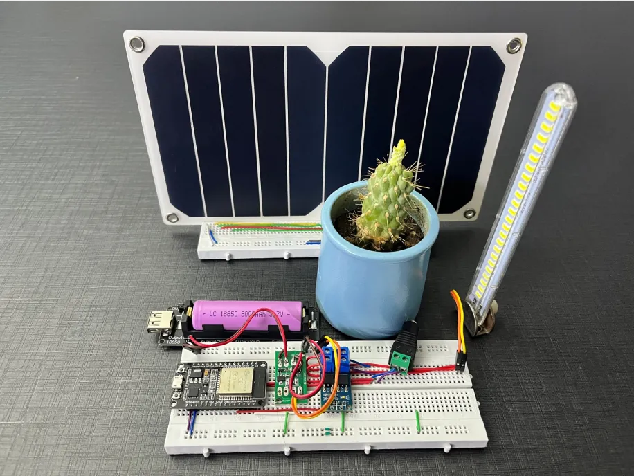

The project aims to optimize plant growth by implementing a scheduled lighting system using the LED strip with the EzloPi device. By leveraging EzloPi's capabilities, the system will automate the timing for plants, mimicking natural sunlight cycles for optimal photosynthesis. Through precise scheduling, it will ensure consistent and appropriate light conditions, promoting healthier and faster plant growth. This project is powered using a solar-charged battery to act as a standalone solution for providing scheduled lighting when natural sunlight levels get very low in the evening or at night time.
Additionally, this system will provide remote monitoring and control options, enabling users to adjust settings conveniently from anywhere using the MiOS smart platform. Overall, the project seeks to revolutionize plant cultivation by harnessing the power of technology for enhanced growth and also enhance energy efficiency.
Welcome to the project demonstration video section. The following video showcases the key aspects of Boost plant health with scheduled lighting using solar-powered batteries, providing a visual walkthrough of its implementation.

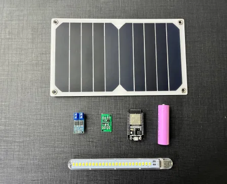

  • ESP32 as an EzloPi smart device.
  • XY-MOS, high-power dual MOSFET driver module.
  • Mini portable lamp (24 LEDs).
  • Solar Panel ZW110X69.
  • Solar panel Controller HW-150.
  • 18650 battery.
The wiring diagram for ESP32 is represented as below:
From ESP32 to the MOSFET driver module:
ESP32 MOSFET driver module
D5 Trig
GND GND
From MOSFET driver module to LED Strip:
MOSFET Driver 24 LEDs mini portable lamp
OUT+ 5V
OUT- GND
From Solar panel to Solar controller:
Solar Panel Solar Controller
Signal + S+
Signal - S-
From 18650 Battery to Solar controller:
18650 Battery Solar Controller
+ve terminal B+
-ve terminal B-
ESP32 Solar Controller
Vin L+
GND L-

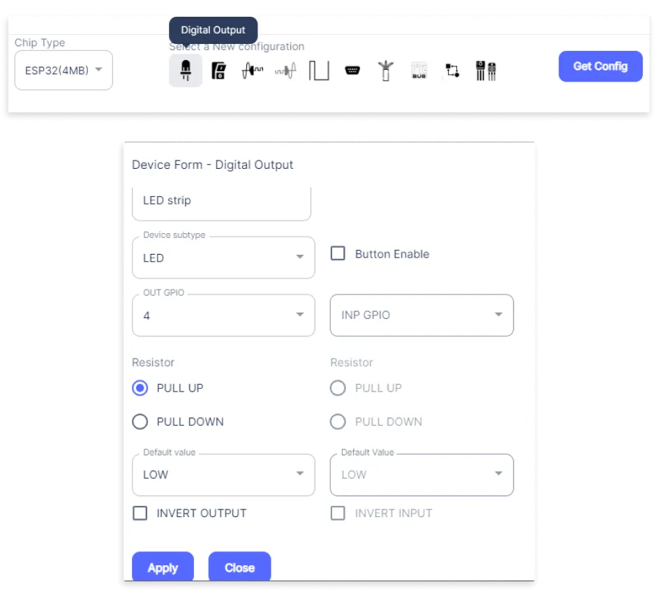

  2. In the Device Configuration, tab click on Digital Output.
  1. A Digital Output window will open for inputting the following parameters:
  • Set device name to LED strip.
  • Set Device subtype to LED.
  • Set OUT GPIO to 4.
  • Set Resistor to PULL UP.
  • Set the default value to LOW.
  • Then Click Apply Button.
  • After clicking the apply button you can see a table of your setting in the device configuration tab.

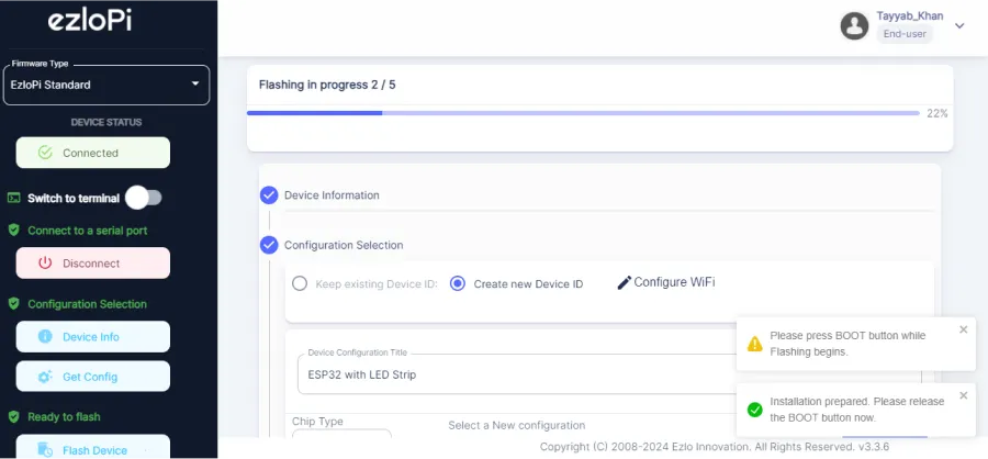

  • Press the Flash Device button.
  1. A window will appear on the bottom right side of the screen displaying “Please press BOOT button while flashing begins.”
  1. Hold the BOOT button down until the next window appears on the bottom right side of the screen which says “Installation prepared. Please release the boot button now.”
  1. Release the BOOT button from your ESP32 when this pop-up on the bottom right window appears.
  1. After some time, a popup will appear saying Device Flashed Successfully! This means that your device has been set up successfully.

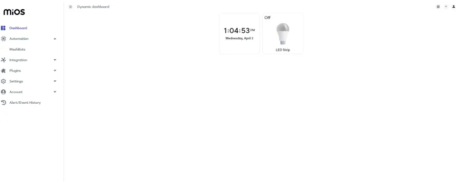

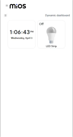

  1. After opening the MiOS web dashboard, you will be able to see the tile of your connected device. Currently the tile is OFF, which indicates that the LED strip is OFF and will turn on according to the MeshBot rules which we will configure below.

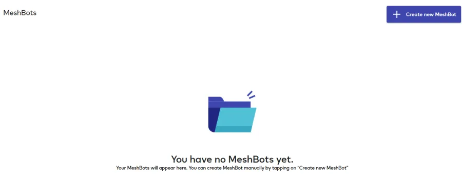

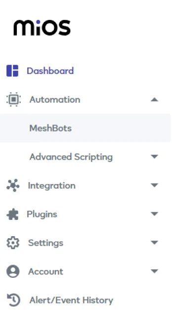

  1. On the right side of the screen under Automation, click on MeshBots.

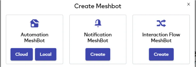

  1. On meshbot screen, click on Create new MeshBot button present on the top right corner of the screen.
  2. After clicking on Create new MeshBot you will see new options, now under Automation MeshBot click on Local.

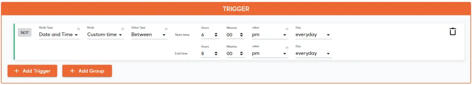

  1. In the trigger tab you can set the TRIGGER for your device and in the ACTION tab you can set the action to be performed based on the trigger which you have created.
  1. Set these values in TRIGGER section:
  • Set Node Type to Date and Time.
  • Set the Node to Custom time and select the time.
  • Set the Value Type to Between.
  • Set the Start time to 6:00 pm and Day to everyday.

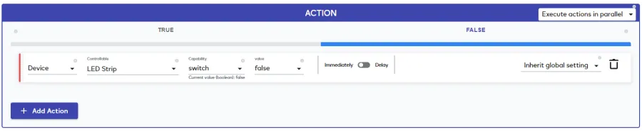

  1. Set these values in the ACTION section.
  • Click on TRUE.
  • Set Node Type to Device.
  • Set Controllable Type to LED strip.
  • Set the Capability Type to switch.
  • Set the Value to true.
  • Set Action to immediately.
  • Click on FA`LSE.
  • Set the Value to false.
  • Now Click the Save button.

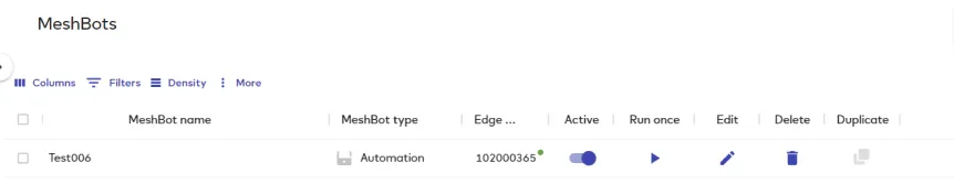

  1. After clicking the save button you can see this screen on the top right corner of the screen.
  1. Here you can see your saved MeshBot. Now click on Dashboard.

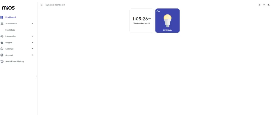

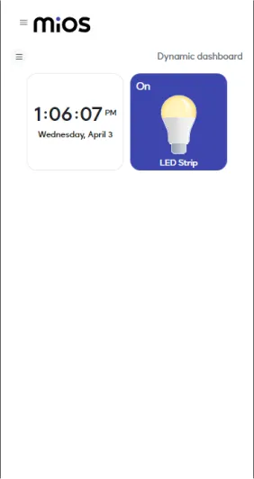

  1. Here in the MiOS web dashboard, you can see that when the set time is reached, the LED strip tile turns on because of the meshbot rules.

  1. After opening the MiOS mobile app dashboard, you will be able to see the tile of your connected device. Currently the tile is OFF, which indicates that the LED light strip is OFF.
  1. Similarly, it can be seen that when the set time is reached, the LED strip tile turns ON indicating that the LED strip is also on. This indicates that the rules we have set in meshbot are working.
