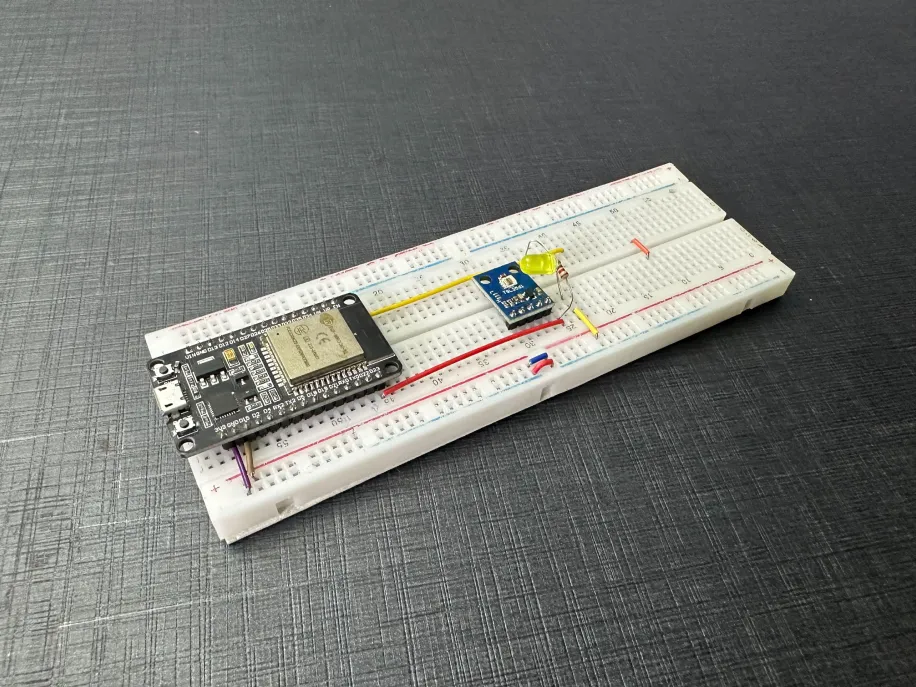

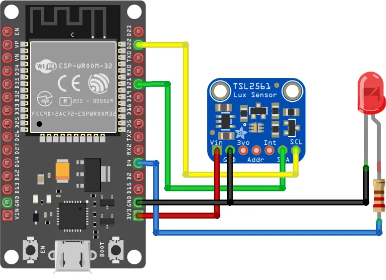

- TSL2561 Luminosity sensor.
- LED with a current limiting resistor of 110 Ohms.
From ESP32 to the TLS256 Luminosity sensor:
ESP32 | TSL2561 |
3V3 | Vin |
GND | GND |
D21 | SDA |
D22 | SCL |
From ESP32 to the LED & Resistor:
ESP32 | LED | Resistor |
D4 | - | 1st Terminal |
GND | Cathode | - |
- | Anode | 2nd Terminal |

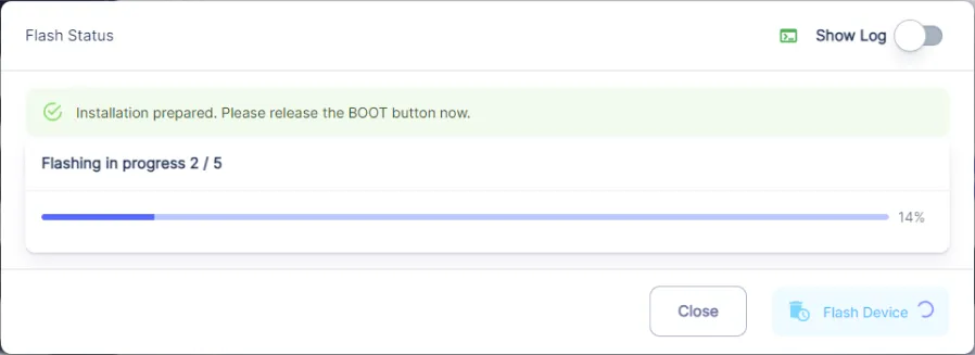

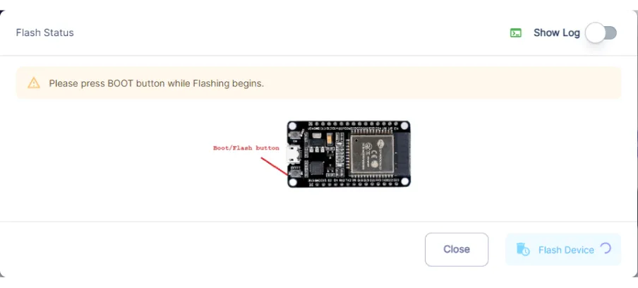

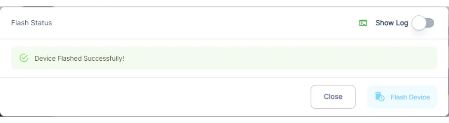

4. Interfacing the Light/Luminosity Sensor (TSL2561) using the EzloPi Web Flasher
Now, select COM Port to which your ESP32 device is connected. In our case, the COM3 port is used.
Click Connect.

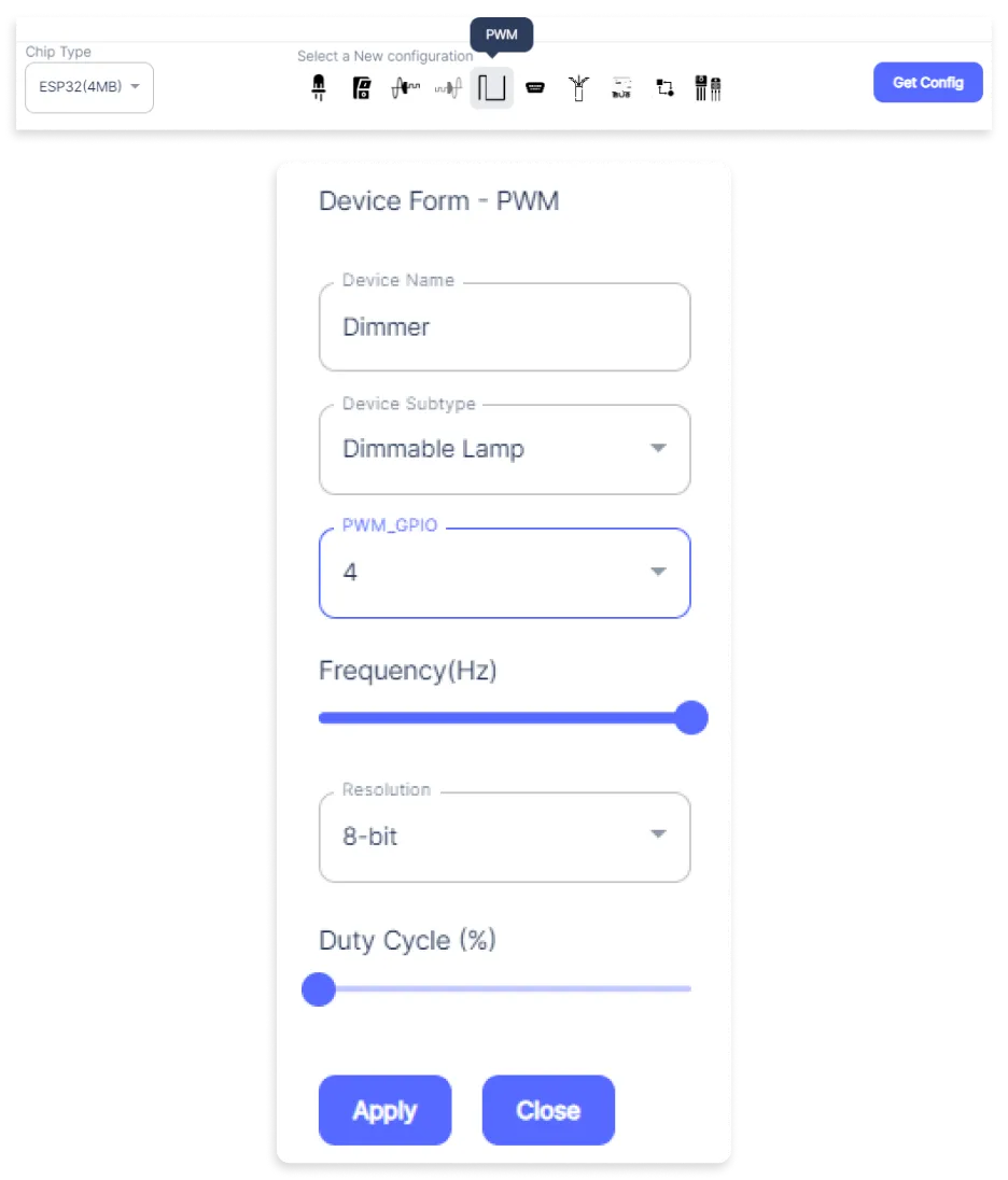

- In the Device Configuration, tab click on PWM.
- A PWM window will open for inputting the following parameters:
- Set a Device Name of your choosing. In our case, we set it to Dimmer.
- Set Device Subtype to Dimmable Lamp.
- Set the PWM_GPIO to 4.
- Set the Resolution to 8 bits.
- Now, Click the Apply button.

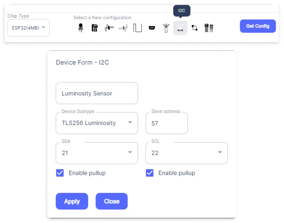

- Again, In the Device Configuration, tab click on I2C.
- A I2C window will open for inputting the following parameters:
- Set a device name of your choosing. In our case, we set it to Luminosity Sensor.
- Set Device subtype to TLS256 Luminosity.
- Set Slave address to 57.
- Set SDA pin to GPIO21.
- Set SCL pin to GPIO22.

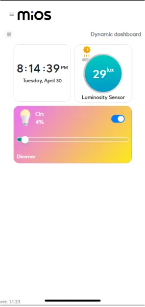

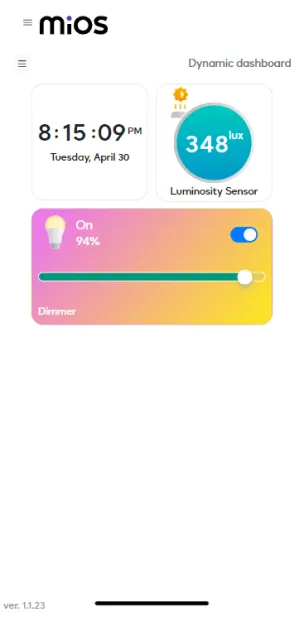

6. MiOS App
- Here, we can see the Luminosity sensor and dimmer tile in the MiOS mobile app above. The above figure indicates that very little amount of light is being detected by the sensor as the intensity of light is controlled using the slider as seen above.
- Here, we can see the Luminosity sensor and dimmer tile in the MiOS mobile app above. The above figure indicates that a high amount of light is being detected by the sensor as the intensity of light is controlled using the slider as seen above.

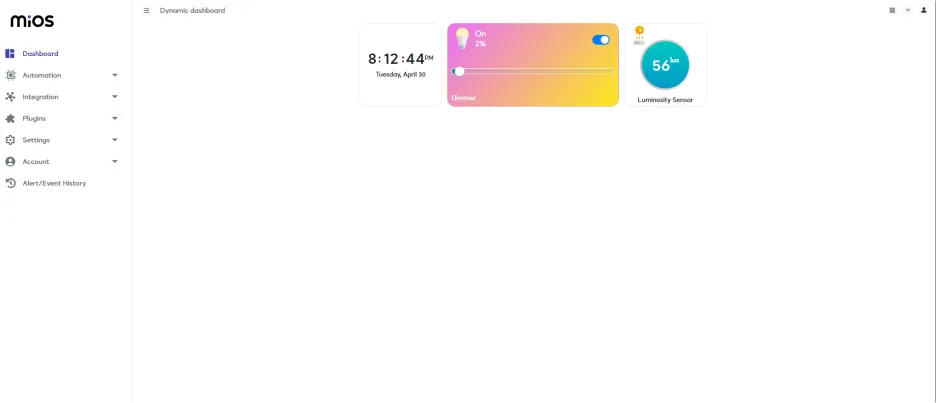

5. MiOS Web Application
- Here, as seen in the MiOS web app above, we can see the Luminosity sensor and dimmer tile. The above figure indicates that very little amount of light is being detected by the sensor as the intensity of light is controlled using the slider as seen above.
- Here, as seen in the MiOS web app above, we can see the Luminosity sensor and dimmer tile. The above figure indicates that a high amount of light is being detected by the sensor as the intensity of light is controlled using the slider as seen above.
