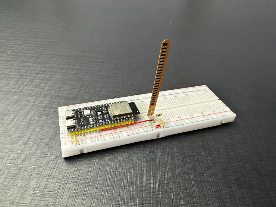

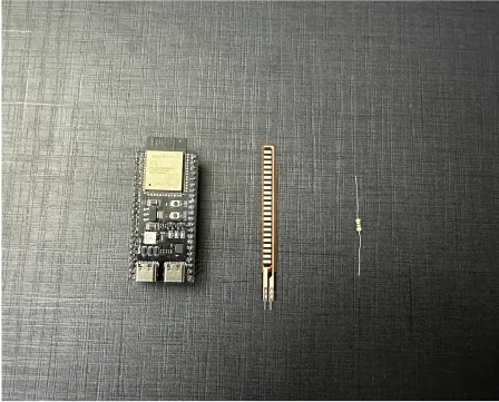

- ESP32S3 as an EzloPi smart device.
- ADA1070 flex sensor.
- Resistor 10 kilo ohms.

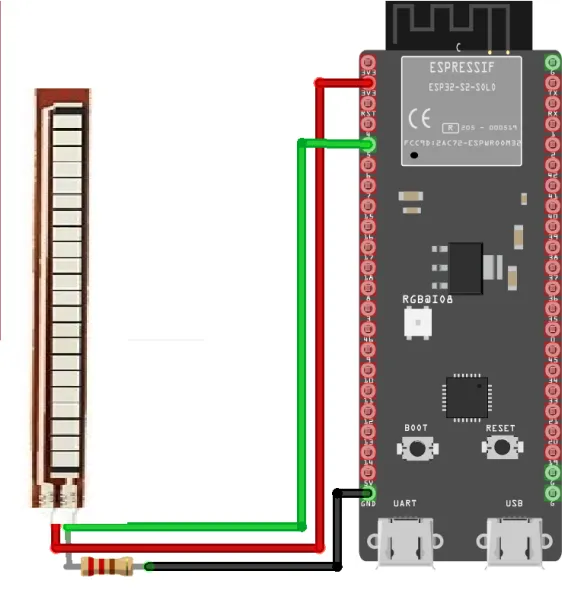

The wiring diagram of ESP32-S3 pin is represented as follows:
From ESP32S3 to the Flex sensor & Resistor:
| ESP32 | Flex sensor | Resistor |
| 3V3 | 1st terminal of the sensor | - |
| GND | - | 1st terminal of the resistor |
| D4 | 2nd terminal of the sensor | 2nd terminal of the resistor |

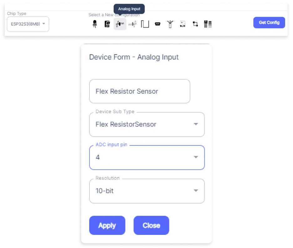

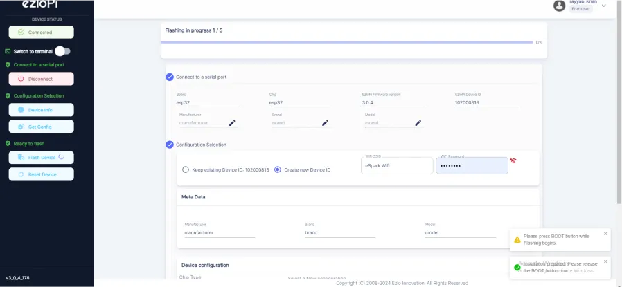

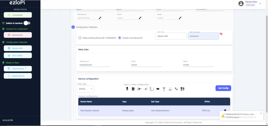

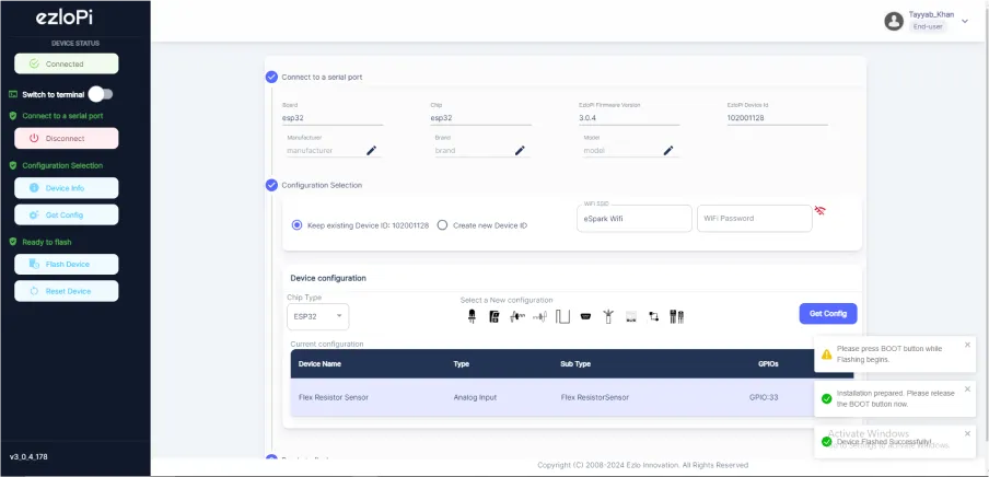

4. Interfacing the Flex sensor by using the EzloPi Web Flasher
Click Connect

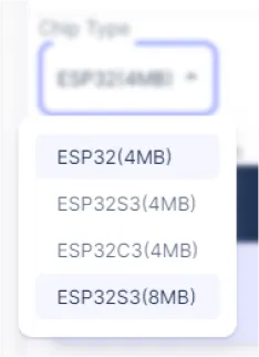

- In the Device Configuration, Select Chip Type ESP32S3(8MB).
- In the Device Configuration, tab click on Analog Input.
- An Analog Input window will open for inputting the following parameters:
- Set a Device name of your choosing. In our case we set it to Flex Resistor Sensor.
- Set the Device Subtype to Flex Resistor Sensor.
- Set the ADC input pin to 4.
- Now, Click the Apply button.

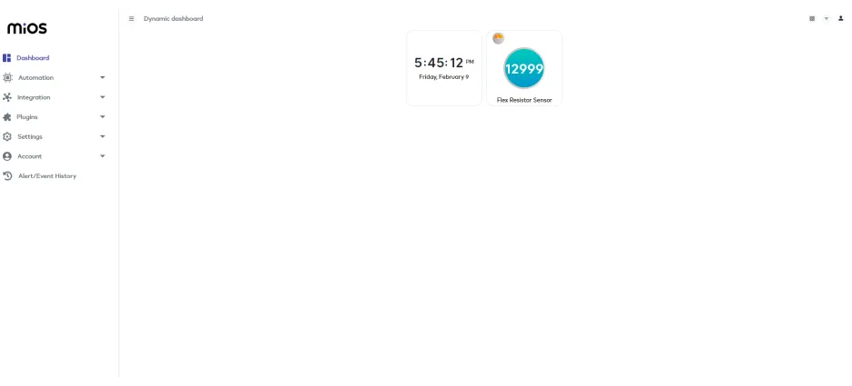

6. MiOS Web Dashboard
- After opening the MiOS web dashboard, you will be able to see the tile of your connected device. We can see the bending force being exerted to the sensor by using the MiOS smart platform.
