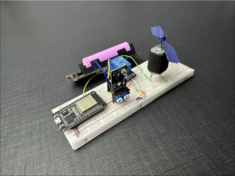

- KY-032 infrared obstacle avoidance sensor.
- Single channel relay module.
- DC motor with DC power supply.

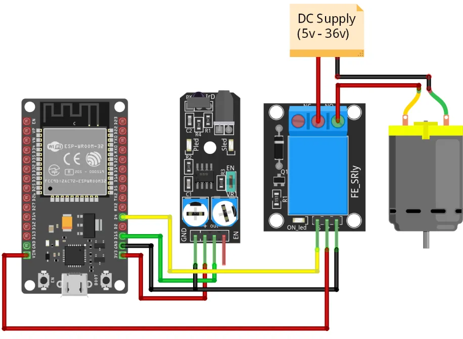

From ESP32 (30 pins) to KY-032:
| ESP32 | KY-032 |
| 3V3 | +ve |
| GND | GND |
| D15 | OUT |
From ESP32 to Relay:
| ESP32 | Relay |
| VIN | +(VCC) |
| GND | -(GND) |
| D4 | S(Signal) |
From DC Motor to Power Supply & Relay:
| Relay | DC Motor | Power Supply |
| COM | - | Positive Terminal |
| NO | Terminal no. 1 | - |
| - | Terminal no. 2 | Negative Terminal |

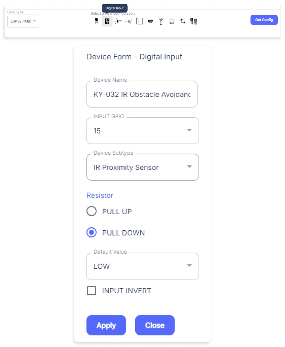

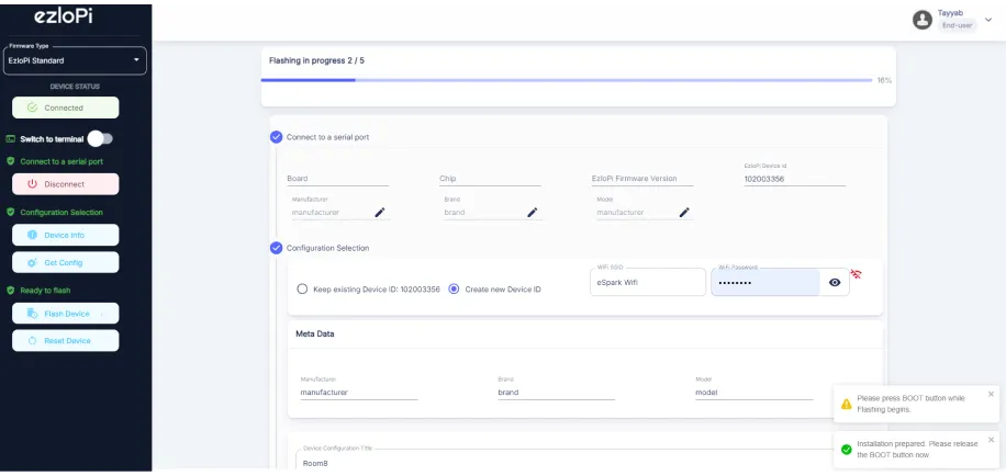

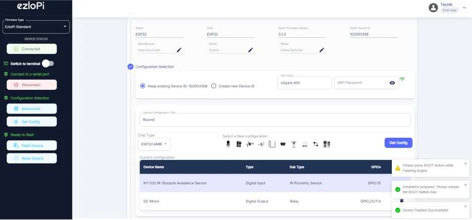

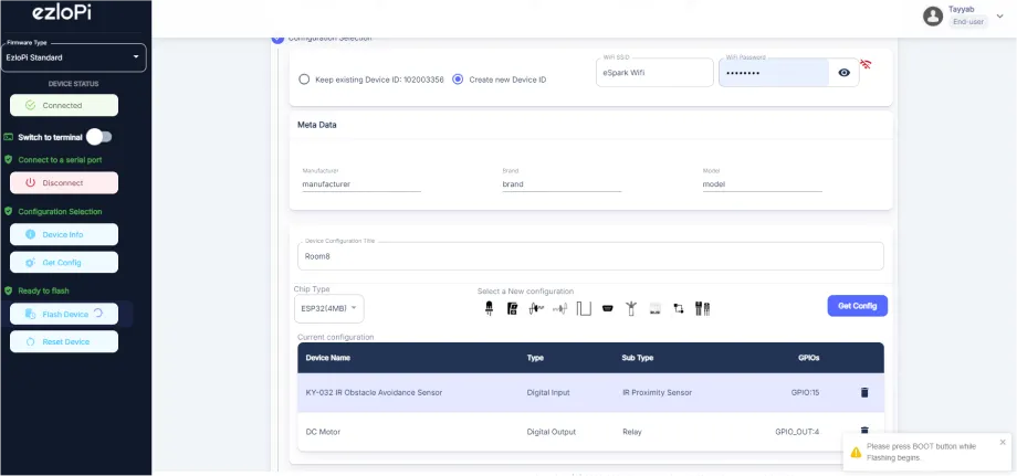

4. Interfacing the KY-032 Sensor using the EzloPi Web Flasher
Click Connect
- A Digital Input window will open for inputting the following parameters:
- Set a device name of your choosing. In our case we set it to KY-032 IR Obstacle Avoidance Sensor.
- Set the Input GPIO to 15.
- Set Device Subtype to IR Proximity Sensor.
- Then Click Apply Button.

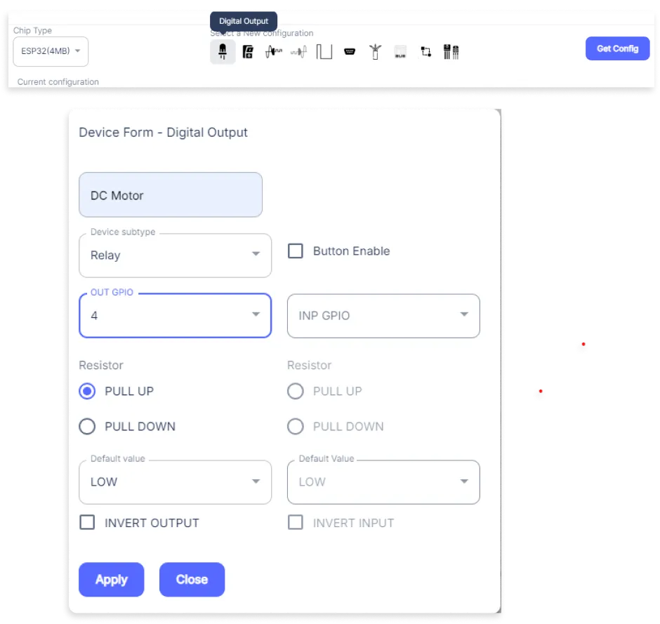

- Set a device name of your choosing. In our case, we set it to DC Motor.
- Set Device subtype to Relay.
- Set OUT GPIO to 4.
- Set Resistor to PULL UP.
- Set the default value to LOW.

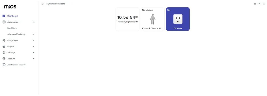

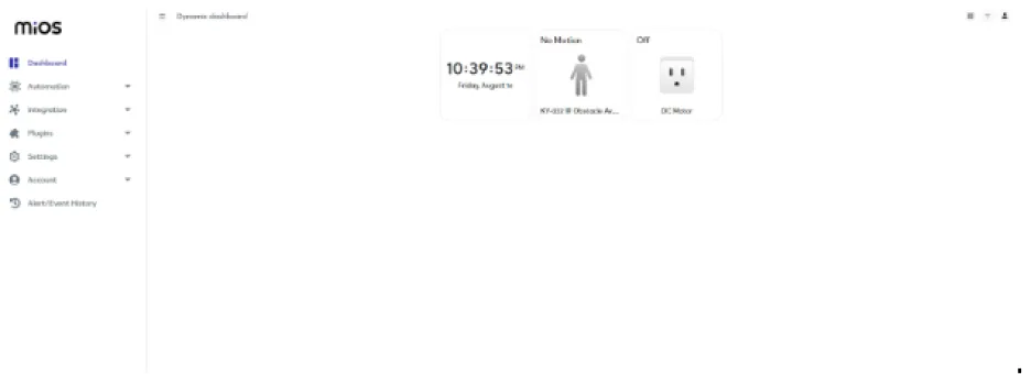

5. MiOS Web Dashboard
- Now, on the MiOS web dashboard, you will be able to see the tiles for the connected devices such as KY-032 IR obstacle avoidance sensor and DC motor. The DC motor tile will indicate the status of the KY-032 depending on the obstacles being detected by the sensor.

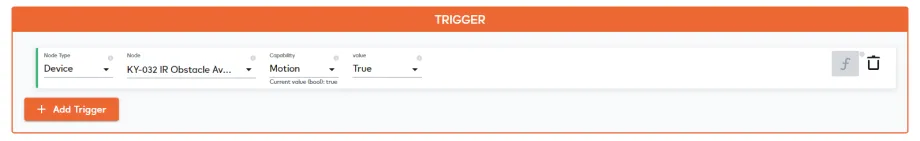

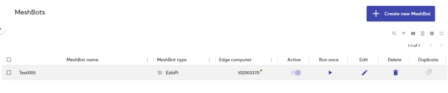

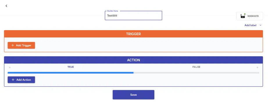

MeshBots:
- After clicking on Create new MeshBot, you will see this now under Automation MeshBot click on Local.
- On the next screen you will see that we can create a name of our choosing, in this case we write it as Test004.
- Set Node Type to Device.
- Set the Node to KY-032 IR Obstacle Avoidance Sensor.
- Set the Capability to Motion.
- Set the value to True.

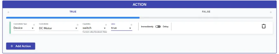

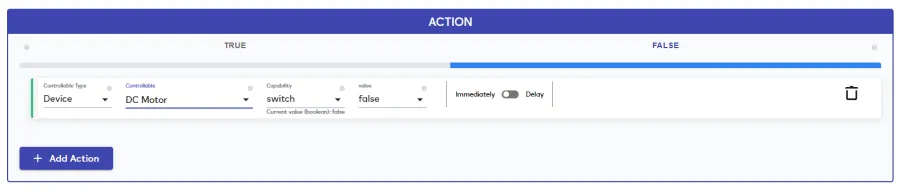

- Set Controllable Type to Device.
- Set the Controllable to DC Motor.
- Set the Capability to switch.
- Set the Value to false.
- Set Action to immediately.
- Set the Value to true.
- Now Click the Save button.

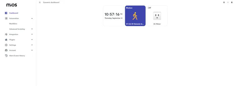

- Here in the MiOS web dashboard, we can see that the DC motor will run depending on the obstacle being detected by the KY-032 sensor according to our settings of meshbot.
- Now, we can see that when the KY-032 IR obstacle avoidance sensor gets triggered or detects an object or obstacle. The DC Motor turns off because of the rules we have set in meshbot.

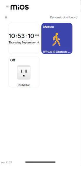

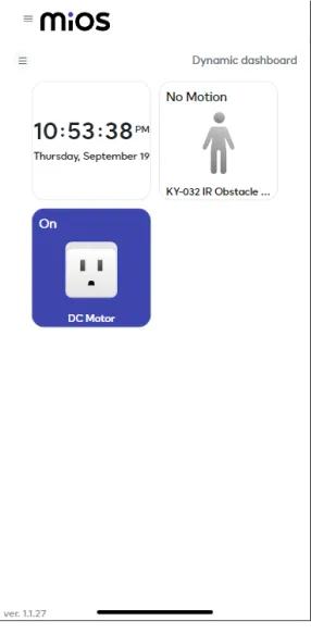

6. MiOS App
- Now, on the MiOS mobile app dashboard, you will be able to see the tiles for the connected devices such as KY-032 IR obstacle avoidance sensor and DC motor. The DC motor tile will indicate the status of the KY-032 depending on the obstacles being detected by the sensor.
