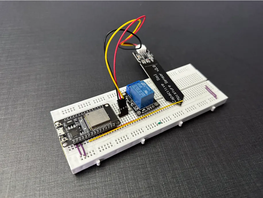

- Capacitive soil moisture sensor module.
- Single channel relay module.
- AC lamp.

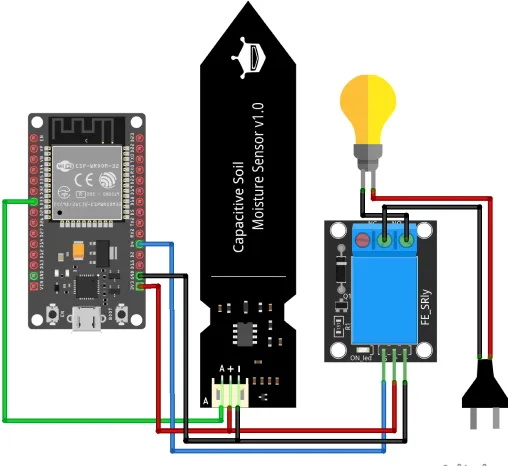

From ESP32 to Soil Moisture Sensor
ESP32 | Soil Moisture Sensor |
3V3 | VCC |
GND | GND |
D33 | A |
From ESP32 to Relay:
ESP32 | Relay |
VCC | VCC |
GND | GND |
D4 | S |
From Relay to Bulb & 220VAC Mains:
Relay | Bulb | 220AC |
COM | NA | Neutral |
NO | 1st terminal | NA |
NA | 2nd terminal | Phase |

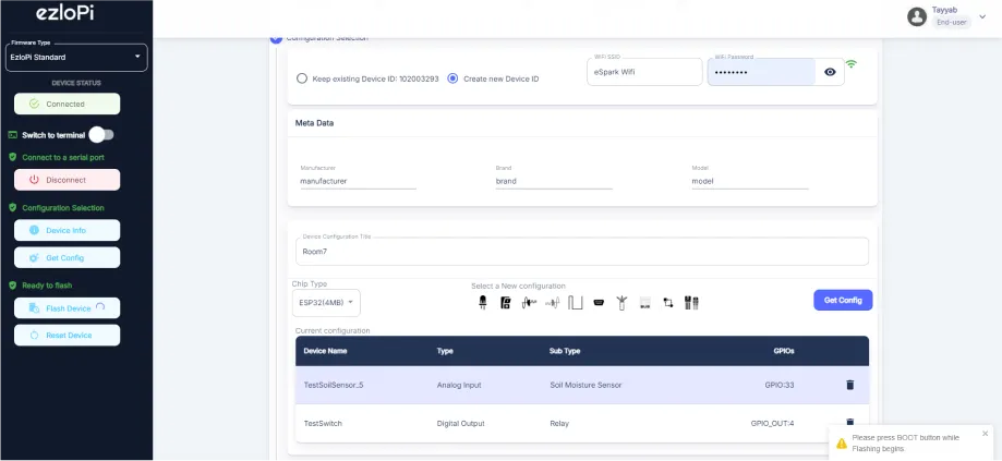

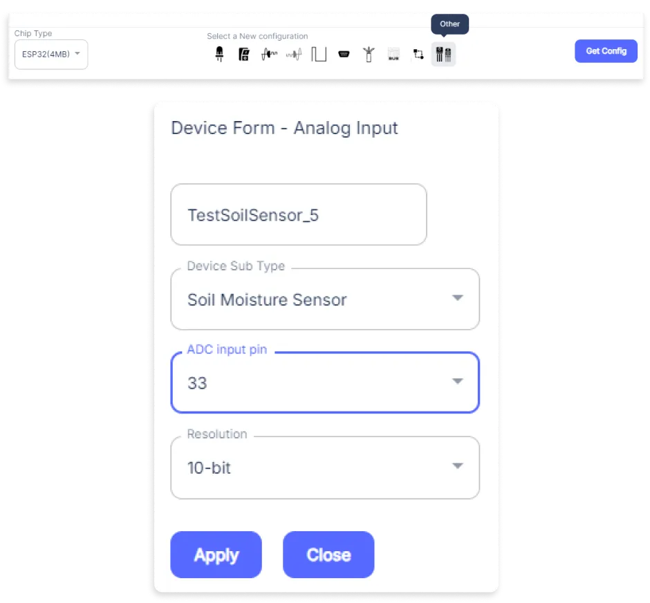

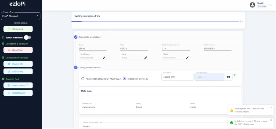

4. Interfacing the Soil Moisture Sensor with EzloPi Web Flasher
Click Connect
- In the Device Configuration, tab click on Analog Input.
- An Analog Input window will open for inputting the following parameters:
- Set a Device name of your choosing. In our case we set it to TestSoilSensor_5.
- Set the Device Subtype to Soil Moisture Sensor.
- Set the ADC input pin to 33.
- Set the Resolution to 10-bit
- Then Click Apply Button.

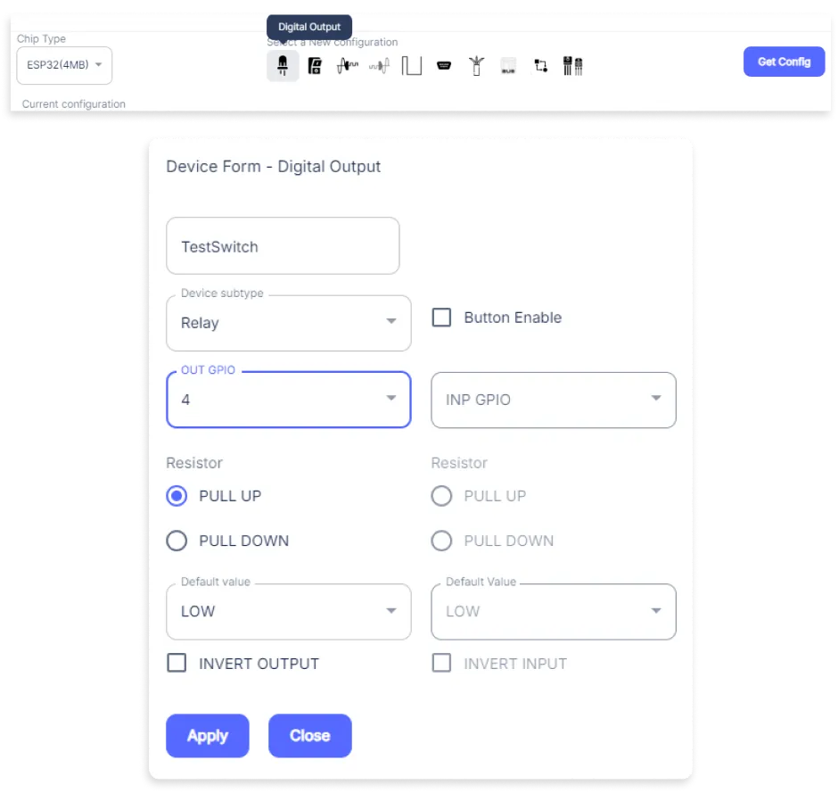

- Set a Device name of your choosing. In our case, we set it to TestSwitch.
- Set Device subtype to Relay.
- Set OUT GPIO to 4.
- Set Resistor to PULL UP.
- Set the default value to LOW.

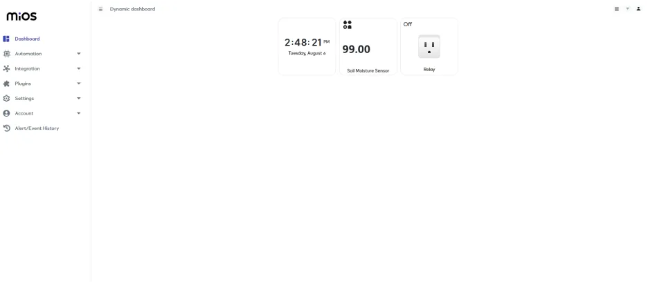

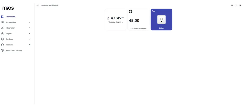

5. MiOS Web Dashboard
- Now, on the MiOS web dashboard, you will be able to see the tile for the soil moisture sensor and the relay. The tile will indicate the status of the relay depending on whether the soil moisture sensor is being operated.

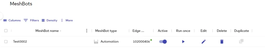

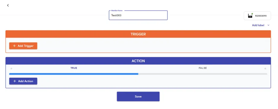

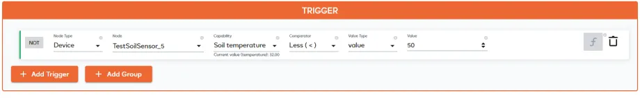

MeshBots:

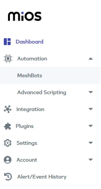

- After clicking on Create new MeshBot, you will see this now under Automation MeshBot click on EzloPi.
- On the next screen you will see that we can create a name of our choosing, in this case we write it as Test003.
- Set Node Type to Device.
- Set the Node to TestSoilSensor_5.
- Set the Capability to Soil temperature.
- Set the Comparator to Less (<).
- Set Value Type to value.
- Set the value to 50.

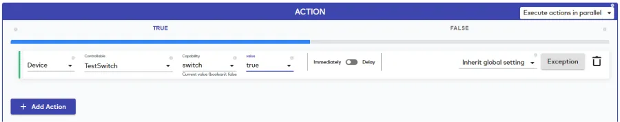

- Set Controllable Type to Device.
- Set the Controllable to TestSwitch.
- Set the Capability to switch.
- Set the Value to true.
- Now Click the Save button.

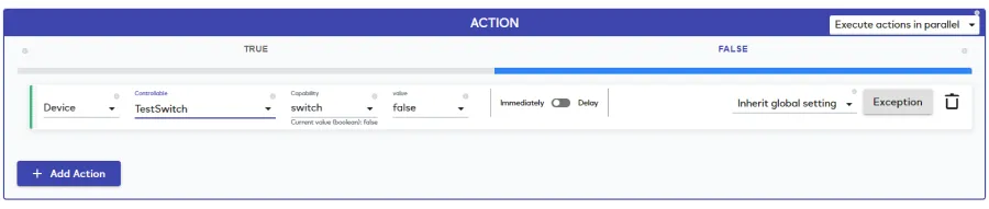

- Set the Value to false.
- In the MiOS web dashboard, you can see that when the Soil moisture sensor detects a moisture value of less than 50%, the relay is turned ON because of the rules we have set in meshbot.

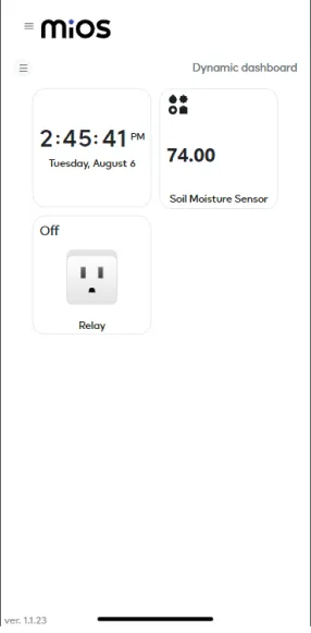

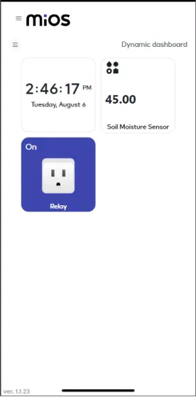

6. MiOS App
- On the MiOS mobile dashboard, you will be able to see the tile for the soil moisture sensor and the relay. Both will function according to rules we have set in meshbot.
- In the MiOS mobile dashboard, you can see that when the soil moisture sensor detects a moisture value of less than 50%, the relay is turned ON because of the rules we have set in meshbot.
