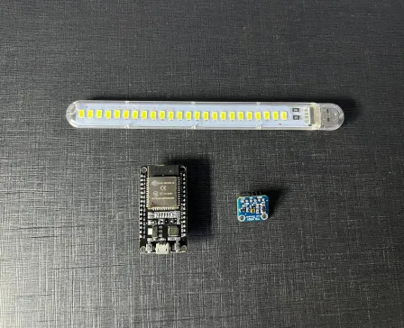

  • ESP32 as an EzloPi smart device.
  • Mini portable booklight (24 LED).
  • LTR303 ALS Luminous Intensity Sensor.

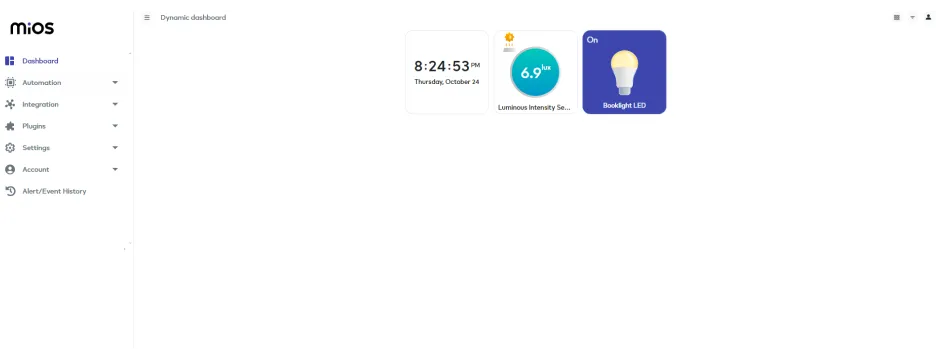

5. MiOS Web Dashboard
  1. After configuring the controller with the EzloPi web flasher, head to ezlogic.mios.com
  1. Use the same credential to log in that you used for configuring the controller with the web flasher.
  1. Here, on the MiOS web dashboard, you will be able to see the tiles of connected devices. In our case we have a light intensity sensor and a booklight LED tiles. The booklight LED tile will indicate the status of the luminous intensity sensor depending on the light being detected by the sensor.

  1. After clicking the save button you can see this screen on the top right corner of the screen.
  1. Here you can see your saved MeshBot. Now click on Dashboard.
  1. Now in the MiOS web dashboard, we can see that when the light intensity detected by the intensity high then the booklight LED remains OFF because of the rules we have set in meshbot.
  1. Here, in the above figure, we can see that when the light intensity detected by the intensity sensor is very low then the booklight LED turns ON because of our meshbot settings.
