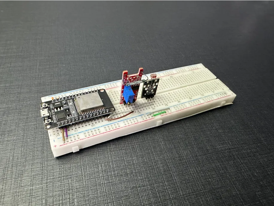

The wiring diagram for the ESP32 30 pin is represented as below:
From ESP32 to KY-025 Reed switch module:
ESP32 | Reed Switch |
VIN | +(VCC) |
GND | G (GND) |
D13 | D0 |
From ESP32 to LDR module:
ESP32 | LDR |
VIN | +5V |
GND | GND |

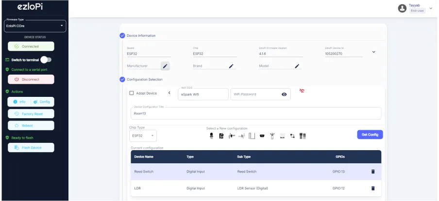

4. Interfacing the KY-025 Reed Switch & LDR Module using the EzloPi Web Flasher
Click Connect

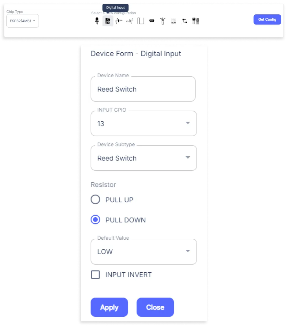

- A Digital Input window will open for inputting the following parameters:
- Set a Device name of your choosing. In our case, we set it to the LDR.
- Set INPUT GPIO to 12.
- Set Device Subtype to LDR Sensor (Digital).
- Set Resistor to PULL DOWN.
- Then Click Apply Button
- Set a Device name of your choosing. In our case, we set it to the LED.
- Set Device Subtype to LED.
- Set the OUT GPIO to 4.
- Set the Resistor to PULL UP.
- Then Click Apply Button.

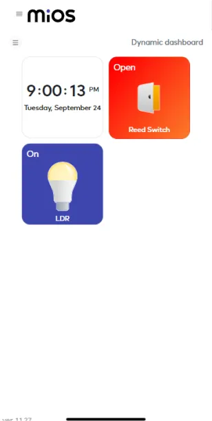

5. MiOS App
- After opening the mobile dashboard, you will be able to see the tiles of your connected devices. The reed switch is showing a “Closed” message while the LDR module is showing an “OFF” message. This situation depicts that it is night time or there is very little light present outside due to which the window blinds are closed.
- Now in the above picture, the reed switch is “Open” and the LDR tile is also turned ON. In this scenario, it shows that it is day time as LDR is receiving light and the window blind opens because the reed switch is also showing an “Open” message.

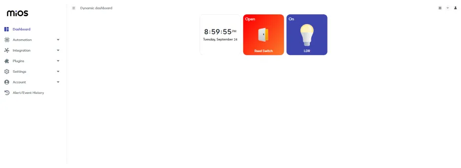

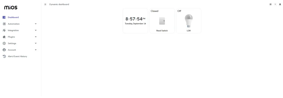

6. MiOS Web Dashboard
- After opening the MiOS web application, you will be able to see the tiles of your connected devices. The reed switch is showing a “Closed” message while the LDR module is showing an “OFF” message. This situation depicts that it is night time or there is very little light present outside due to which the window blinds are closed.
MeshBots:
