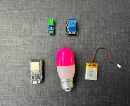

- ACS712 Current sensor.
- Single channel relay module.
- AC Lamp
- 220 Power source

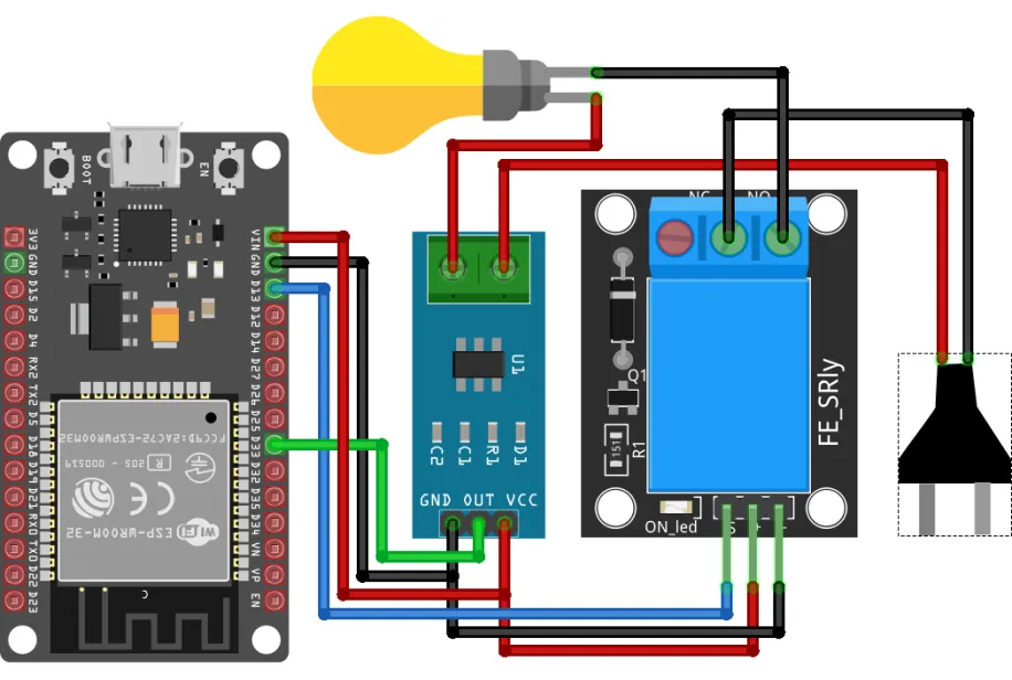

From ESP32 to the ACS712:
| ESP32 | ACS712 |
| VIN | VCC |
| GND | GND |
| D33 | OUT |
From ESP32 to the Relay:
| ESP32 | Relay |
| VIN | +(VCC) |
| GND | -(GND) |
| D33 | S (Signal) |
From Relay to Bulb & 220AC Mains:
| Relay | Bulb | 220V |
| COM | NA | Neutral |
| NO | 1st Terminal | NA |
| NA | 2nd Terminal | Phase |

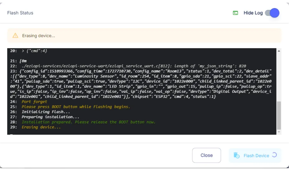

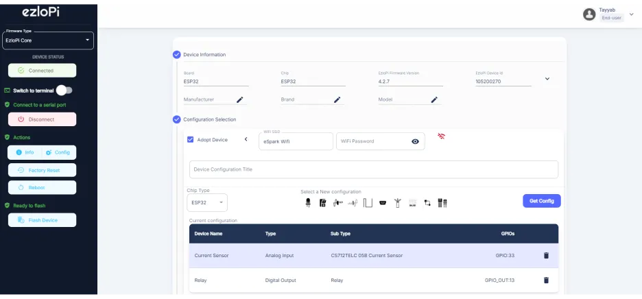

4. Interfacing the Current Sensor & Relay using the EzloPi Web Flasher:
Click Connect

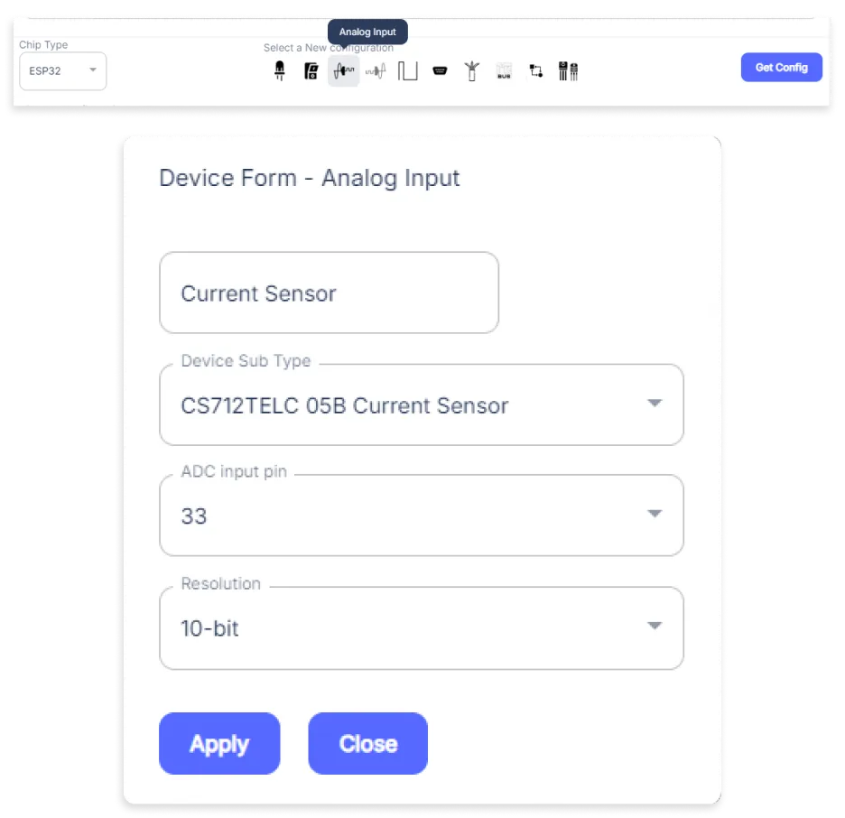

- In the Device Configuration, tab click on Analog Input.
- An Analog Input window will open for inputting the following parameters:
- Set a Device Name of your choosing. In our case, we set it to Current Sensor.
- Set Device Subtype to CS712TELC 05B Current Sensor
- Set the ADC input pin to 33.
- Set the Resolution to 10-bit.
- Then Click Apply Button.

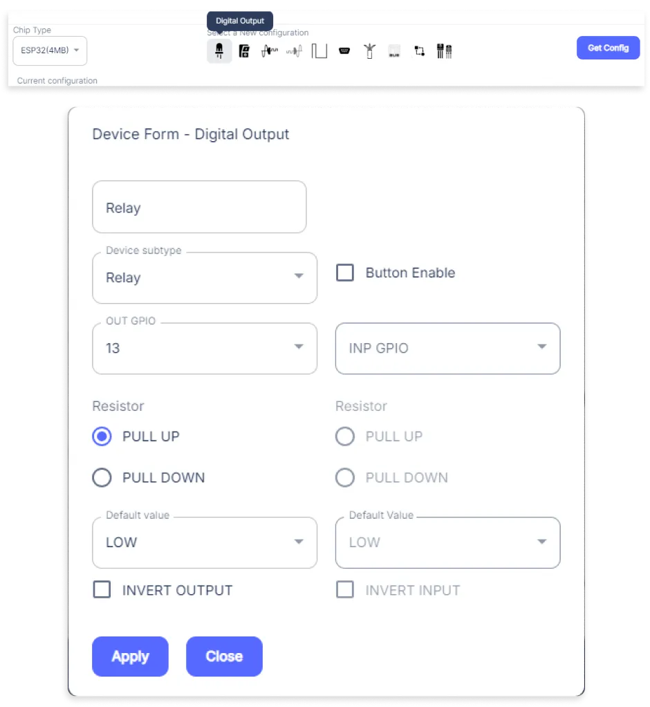

- Set a Device name of your choosing. In our case, we set it to the Relay.
- Set Device Subtype to Relay.
- Set the OUT GPIO to 13.
- Set the Resistor to PULL UP.

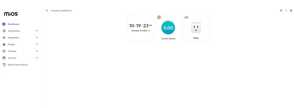

5. MiOS Web Dashboard
- Here, on the MiOS web dashboard, you will be able to see the tiles of connected devices. In our case we have an ACS712 current sensor and relay tiles. The relay tile will indicate the status of the current sensor whether or not the current within the set threshold.

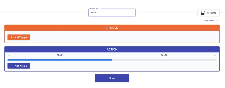

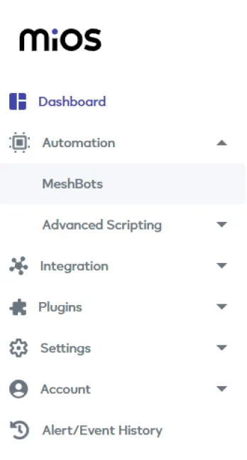

MeshBots:
- After clicking on Create new MeshBot, you will see this now under Automation MeshBot click on Local.

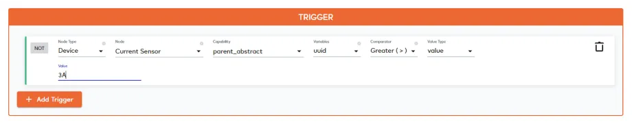

- On the next screen you will see that we can create a name of our choosing, in this case we write it as Test002.
- Set Node Type to Device.
- Set the Node to Current Sensor.
- Set the Capability to parent_abstract.
- Set the variables to uuid.
- Set the Comparator to Greater(>).
- Set the Value Type to value.
- Set the value to 3A.

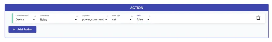

- Set Controllable Type to Device.
- Set the Controllable to Relay.
- Set the Capability to power_command.
- Set the Value Type to set.
- Set the Value to false.
- Now Click the Save button.

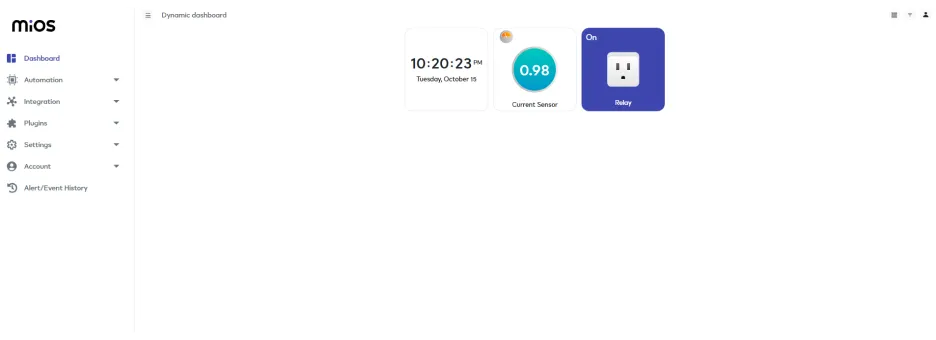

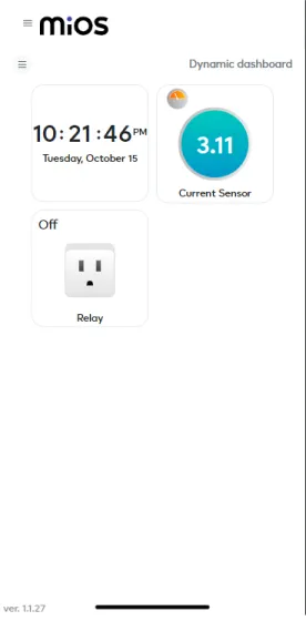

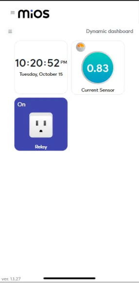

- Now in the MiOS web dashboard, we can see that when the current passing through current sensor is normal value and in our range, our relay is ON to and allow the current to pass through to the circuit according to the condition set in the meshbot.

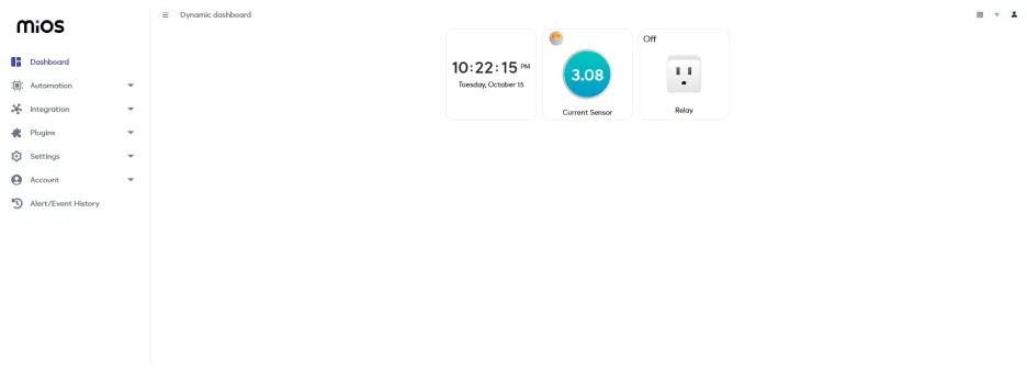

- Here in the above picture, it shows that when the current is out of limit and above our range then the relay turns OFF because of our meshbot setting to protect our whole circuit.

- On the MiOS mobile dashboard, we can see that when the current passing through current sensor is normal value and in our range, our relay is ON to and allow the current to pass through to the circuit according to the condition set in the meshbot.
