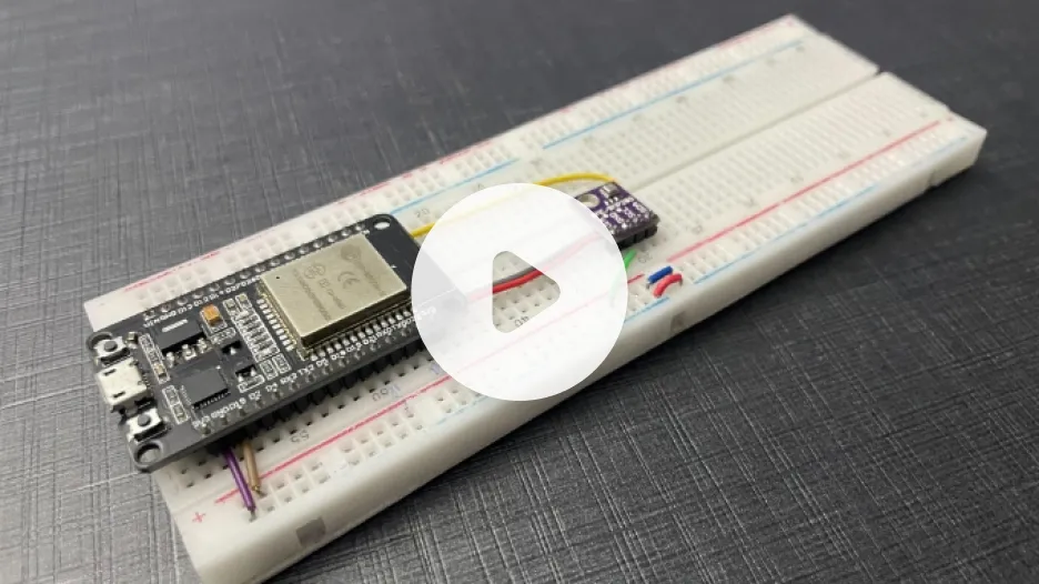

Welcome to the project demonstration video section. The following video showcases the key aspects of Atmospheric pressure measurement using BME280 sensor, providing a visual walkthrough of its implementation.

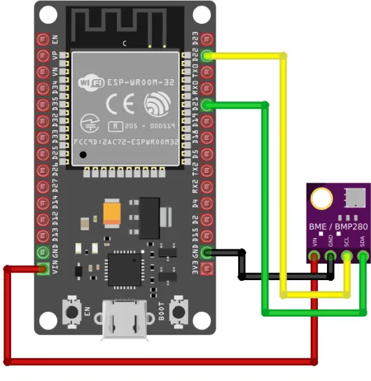

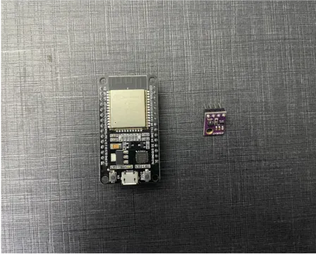

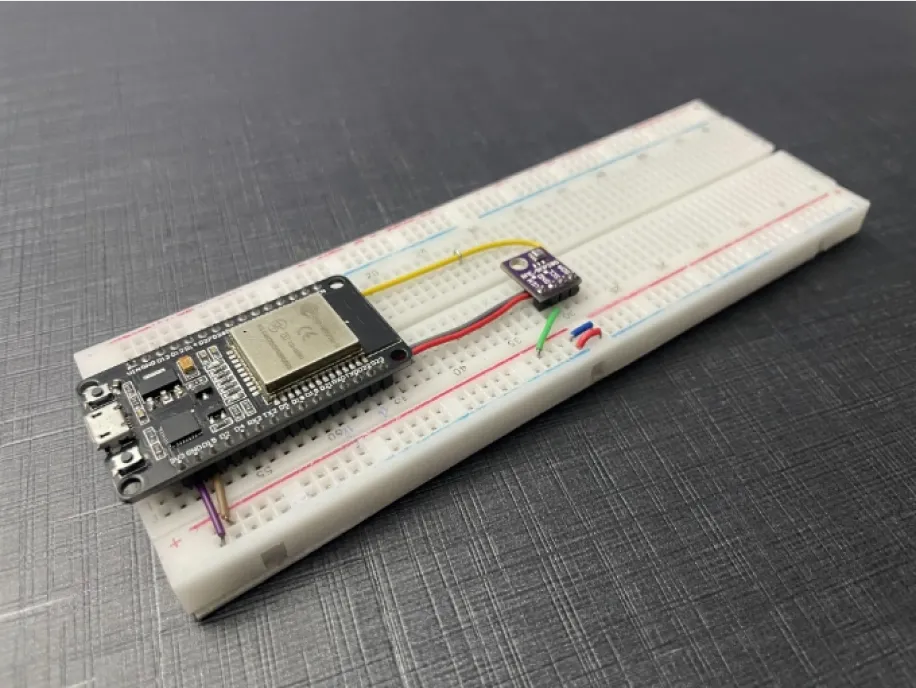

- 5V BME280 Barometric Pressure & humidity sensor.
From ESP32 to the BMP280::
ESP32 | BMP280 |
VIN | VIN |
GND | GND |
D21 | SDA |
D22 | SCL |

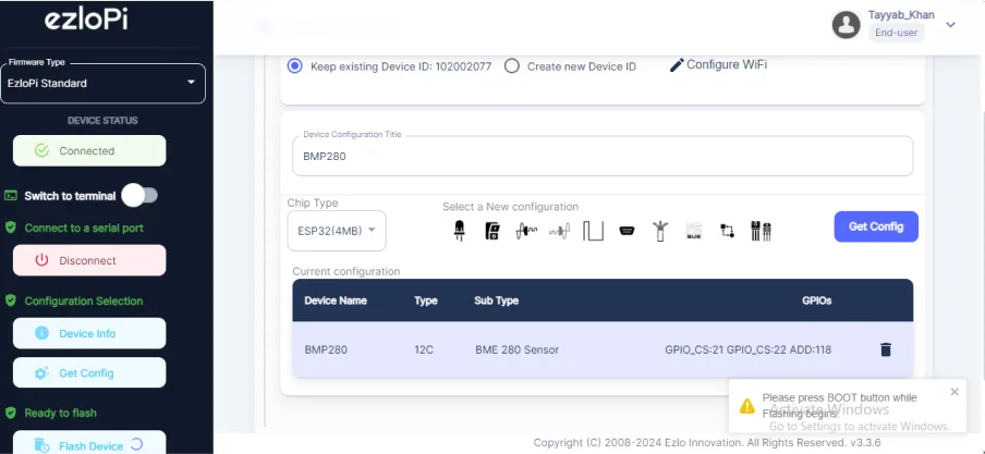

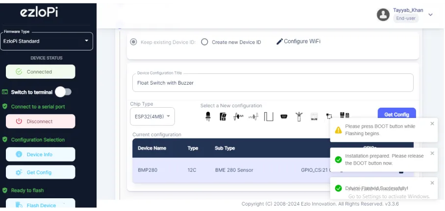

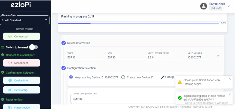

4. Interfacing the BMP280 Pressure Sensor using the EzloPi Web Flasher

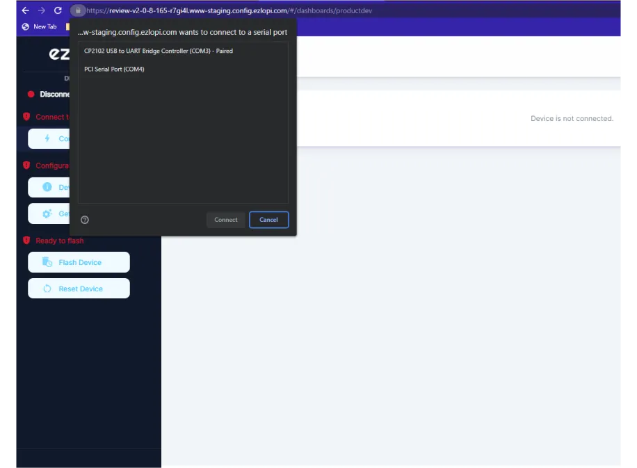

1. First setup your MiOS account by visiting https://www.ezlopi.com/set-up-mios-account and set up your device/hardware by visiting config.ezlopi.com
Click Connect
- If you are new to this and it's your first time configuring, select Create new Device ID. Click on the Configure Wifi button. Enter Wifi SSID and Wifi Password.

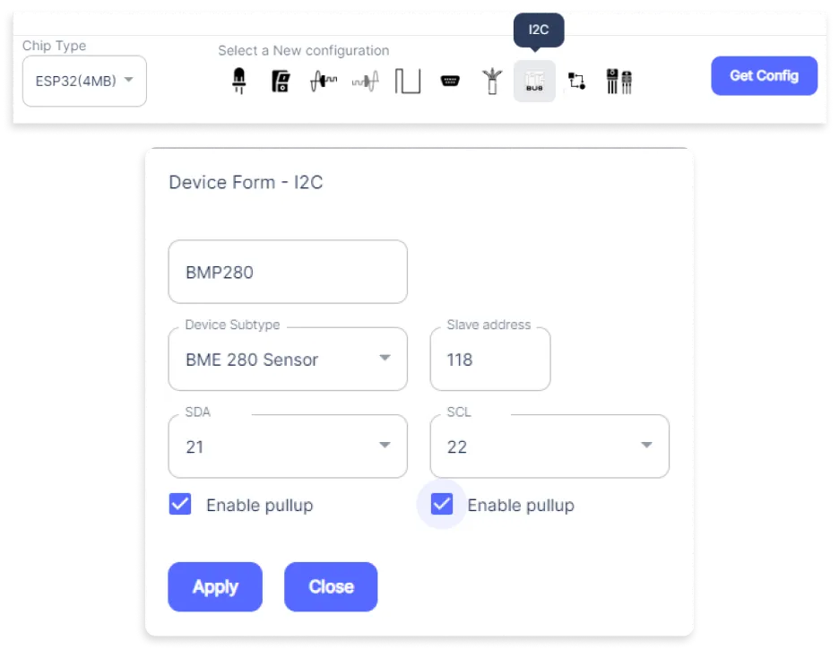

- In the Device Configuration, tab click on I2C.
- A Digital Input window will open for inputting the following parameters:
- Set a device name of your choosing. In our case, we set it to BME280.
- Set Device Sub Type to BME280 I2C.
- Set the Slave Address to 118.
- Set the SDA pin to 21.
- Set the SCL pin to 22.
- Tick the “Enable Pullup” for both the SDA and SCL
- Now Click the Apply button.

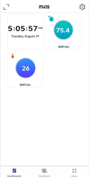

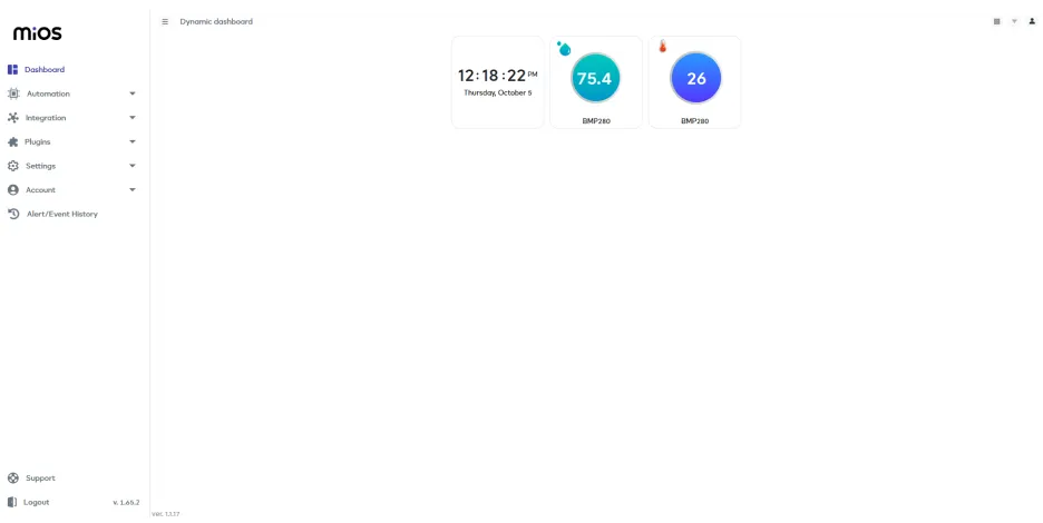

5. MiOS App
- After opening the dashboard, you will be able to see the tile of your connected device. As we can see above in the MiOS mobile dashboard, the BMP280 sensor module tile is showing the current pressure and temperature values.
5. MiOS Web Dashboard
- After opening the MiOS web dashboard, you will be able to see the tile of your connected device. As we can see above, the BMP280 sensor module tile is showing the current pressure and temperature values.
