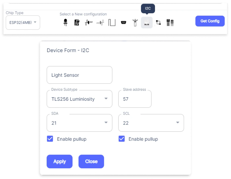

  1. If you are new to this and it's your first time configuring, select Create new Device ID. Enter Wifi SSID and Wifi Password.
  2. In the Device Configuration, tab click on I2C.
  1. A I2C window will open for inputting the following parameters:
  • Set a device name of your choosing. In our case, we set it to Light Sensor.
  • Set Device subtype to TLS256 Luminosity.
  • Set Slave address to 57.
  • Set SDA pin to GPIO21.
  • Set SCL pin to GPIO22.Now Click the Apply button.
  • After clicking the apply button you can see a table of your setting in the device configuration tab.
  • Press the Flash Device button.

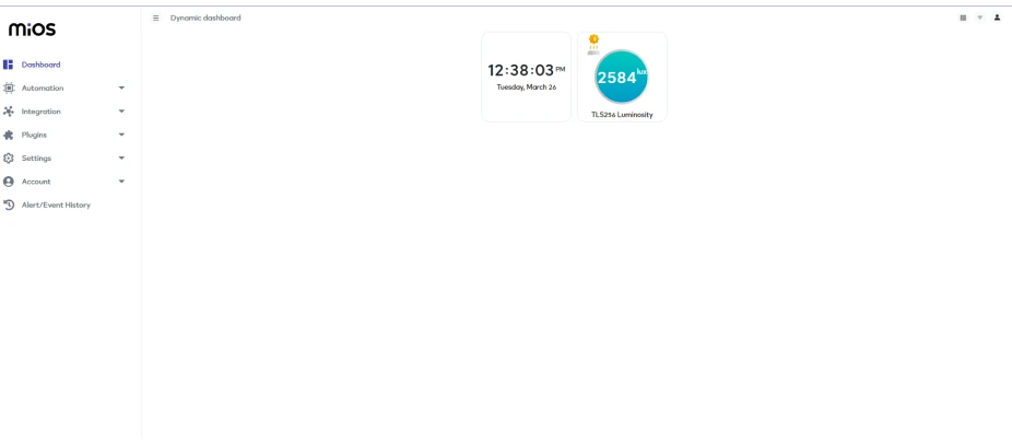

  1. After configuring the controller with the EzloPi web flasher, head to ezlogic.mios.com
  1. Use the same credential to log in that you used for configuring the controller with the web flasher.
  1. Here, as seen in the MiOS web app above, we can see the Luminosity sensor tile. The above figure indicates that very little amount of light is being detected by the sensor as its tile shows the value of intensity of light being measured.
MeshBots:
  1. Here, it can be seen that now more light is being detected by the Luminosity sensor, as the amount of light detected by the sensor has increased.
