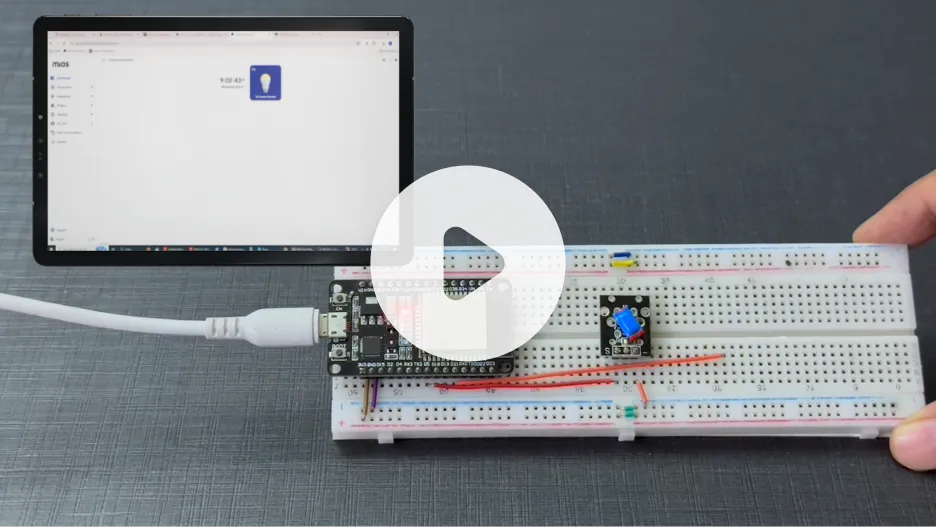

The following project aims to interface the KY-20 tilt switch module with the EzloPi device to detect orientation changes. The KY-20 module is a simple tilt sensor which reacts to tilt movements. The EzloPi device reads the digital signal from the KY-20 module and executes predefined actions which the user has set based on the tilt status. This project setup can be used for applications like motion detection, security systems, and automatic device shutdowns in case of abnormal tilts. The project involves wiring the components, configuring the EzloPi device to interpret the tilt sensor's output, handle the sensor’s data and trigger appropriate responses.

  • ESP32 as an EzloPi smart device.
  • KY-020 Tilt switch module.
From ESP32 to KY-020:
ESP32 KY-020
VCC Vin
GND GND
D5 S (Signal)
