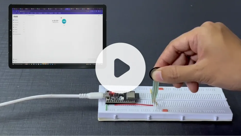

Welcome to the project demonstration video section. The following video showcases the key aspects of Getting started with ESP32-C3 and Force Sensitive Resistor (FSR402), providing a visual walkthrough of its implementation.
Project Video Demonstration
