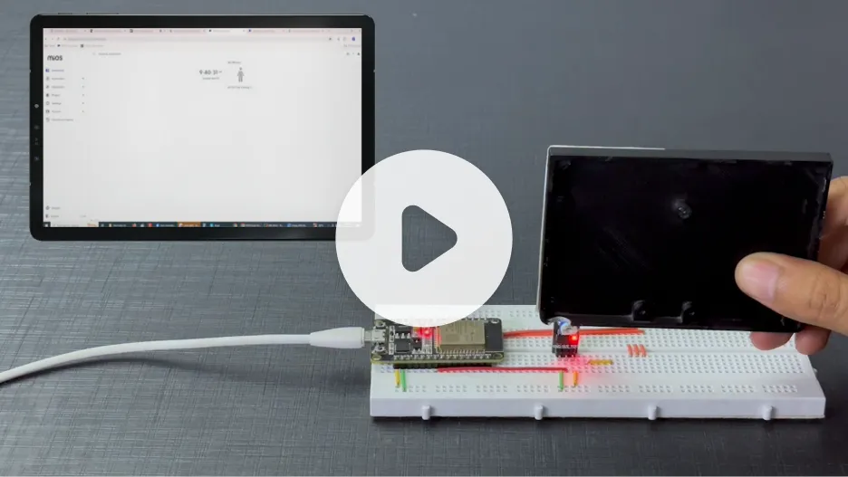

Welcome to the project demonstration video section. The following video showcases the key aspects of Line detection using KY-33 line sensor, providing a visual walkthrough of its implementation.
Project Video Demonstration

  1. After opening the dashboard, you will be able to see the tile of your connected device. As you can see in the MiOS mobile app dashboard, we can see the line sensor tile which lights up when any black line is detected by the sensor. For now, nothing is being detected.
  1. Here, it can be seen that the line sensor tile lit up which indicates that it is detecting black line.
