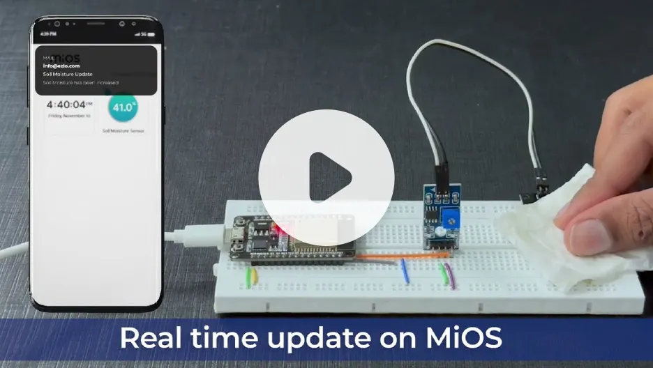

In this project, we seamlessly integrate a soil moisture sensor with the EzloPi Smart Device. We've created a system that provides real-time insights into the moisture levels of your soil. Receive prompt email notifications that keep you informed and in control, also monitor the moisture levels of the soil through the MiOS user-friendly interface, ensuring optimal conditions for your plants, wherever they may be. The EzloPi Smart Device becomes your intelligent assistant allowing integration of automated watering systems, offering timely updates and helping you create the perfect environment for your plants to thrive.
Welcome to the project demonstration video section. The following video showcases the key aspects of Send automatic email notification using soil moisture sensor on EzloPi Platform, providing a visual walkthrough of its implementation.
