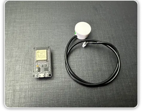

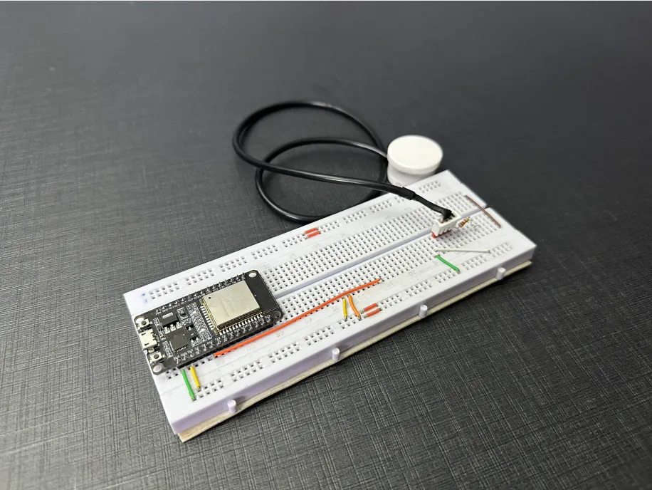

- JSN-SR04T Ultrasonic sensor with analog to digital interface module

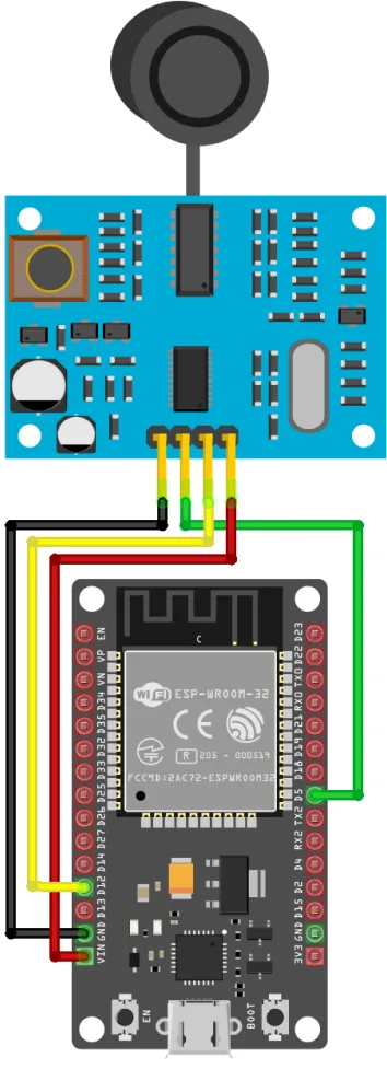

From ESP32 to the JSN-SR04T:
ESP32 | JSN-SR04T |
VIN | VIN |
GND | GND |
D5 | ECHO PIN |
D12 | TRIG PIN |

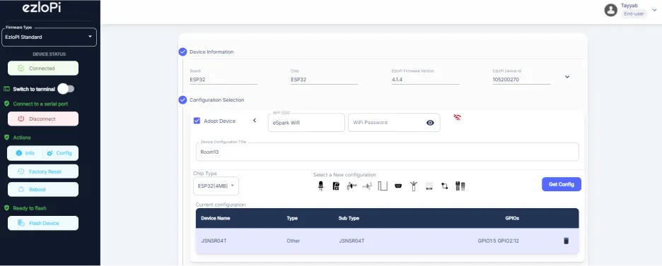

4. Interfacing the Ultrasonic sensor with the EzloPi Web Flasher:
Click Connect

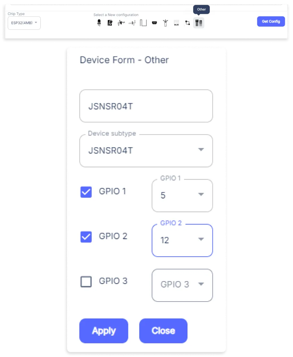

- In the Device Configuration, tab click on Other.
- A window will open for inputting the following parameters:
Set a Device name of your choosing. In our case, we set it to JSNSR04T.
Set Device Subtype to JSNSR04T.
Set the GPIO1 to 5.
Set the GPIO2 to 12.
Then Click Apply Button.

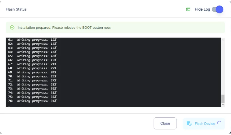

After clicking the apply button you can see a table of your setting in the device configuration tab.

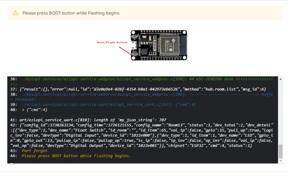

Press the Flash Device Button.

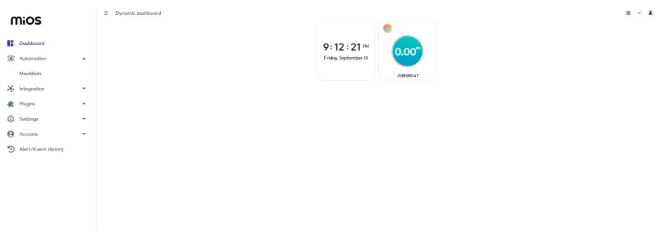

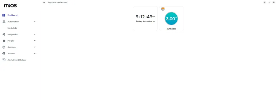

- On the MiOS web dashboard, you will be able to see the tile of the connected device. In our case, we have a JSN-SR04T waterproof ultrasonic sensor. It is currently showing the distance from the water in the tank.

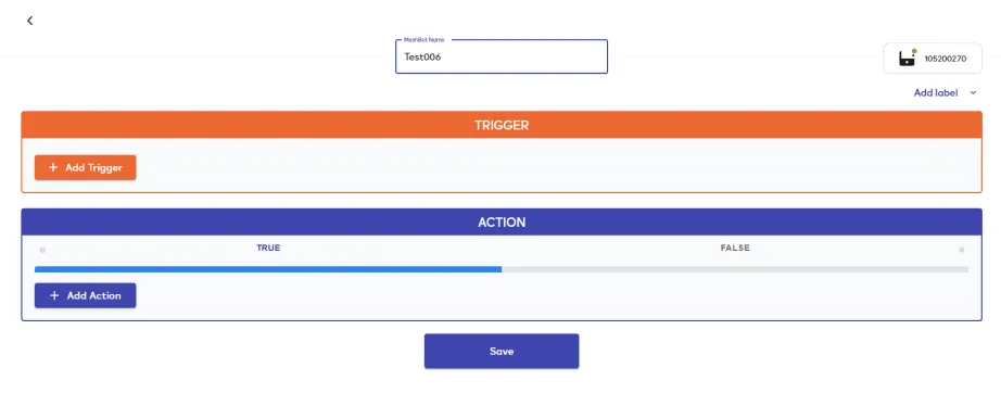

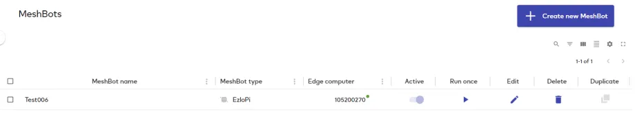

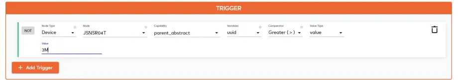

MeshBots:
- After clicking on Create new MeshBot, you will see this now under Notification MeshBot click on Create.
- On the next screen you will see that we can create a name of our choosing, in this case we write it as Test006.
- Set Node Type to Device.
- Set the Node to JSNSR04T.
- Set the Category to parent_abstract.
- Set the variables to uuid.
- Set the Comparator to Greater (>).
- Set the Value Type to value.
- Set the value to 3M.

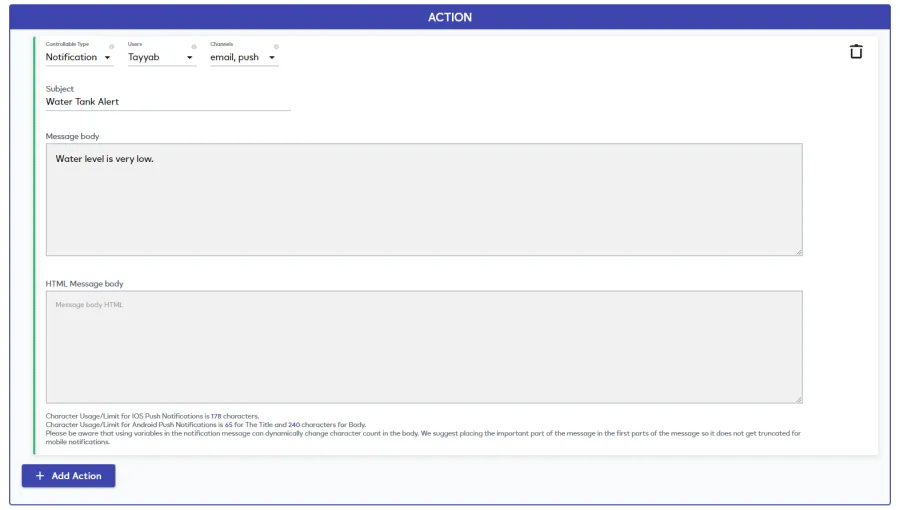

- Set these values in the ACTION section.
- Set Controllable Type to Notification.
- Set the User to Your user account but in our case the user account is Tayyab.
- Set the Channels to email,push.
- Set the Subject to Water Tank Alert.
- Set the Message body info to Water level is very low.
- After clicking the apply button you can see a table of your setting in the Current configuration tab.
- Now Click the Save button.
- Now as seen in the MiOS web dashboard, it is showing a distance of 3 meters. Now, when the distance reaches a certain value defined by the user then an automated email is sent to the user alerting of the low level of water according to our setting of meshbot.

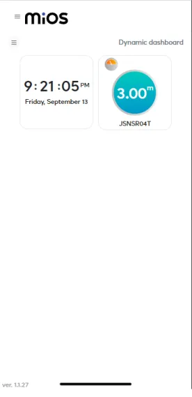

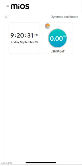

- On the MiOS mobile dashboard, you will be able to see the tile of the connected device. In our case, we have a JSN-SR04T waterproof ultrasonic sensor. It is currently showing the distance from the water in the tank.
