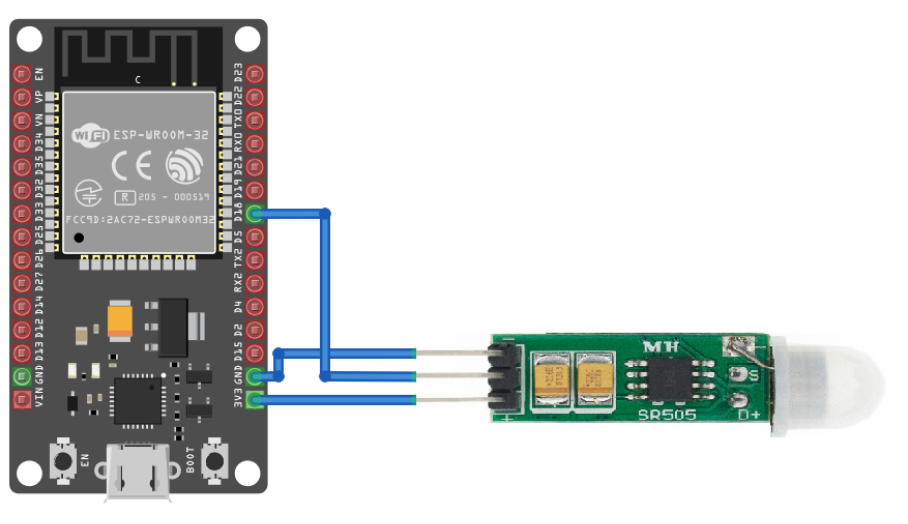

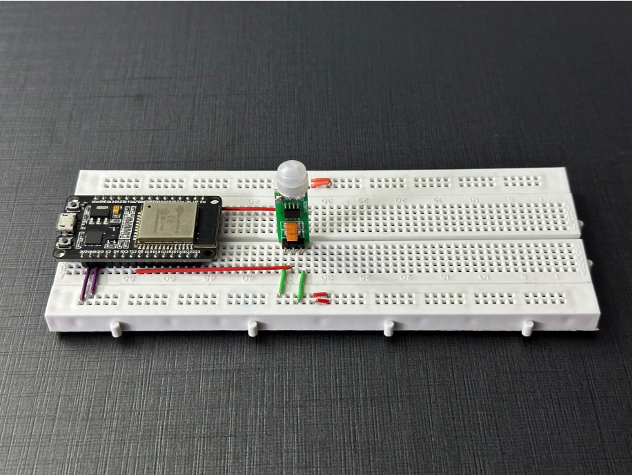

The wiring diagram for ESP32 30 pin is represented as follows:
From ESP32 to PIR motion sensor (HC-SR505):
- Connect 3V3 from the ESP32 to the VCC of the sensor.
- Connect GND from the ESP32 to the GND pin of the sensor.
- Connect D5 from the ESP32 to the DATA pin of the sensor.

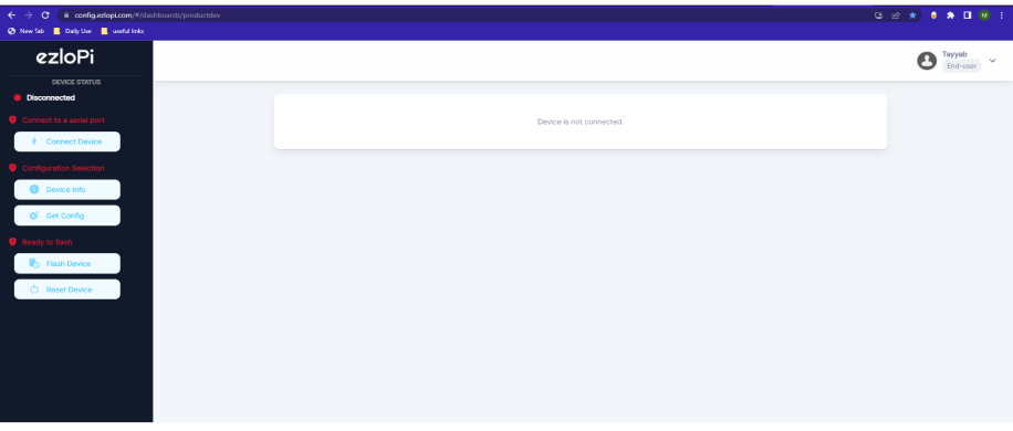

4. Interfacing the PIR motion sensor (HC-SR505) using the EzloPi Web Flasher

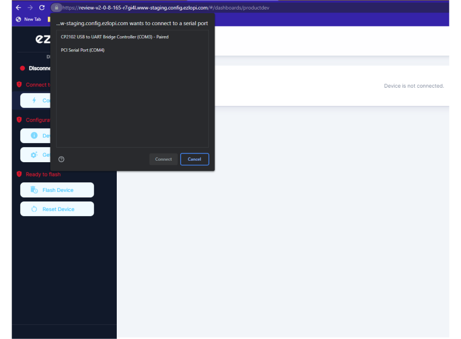

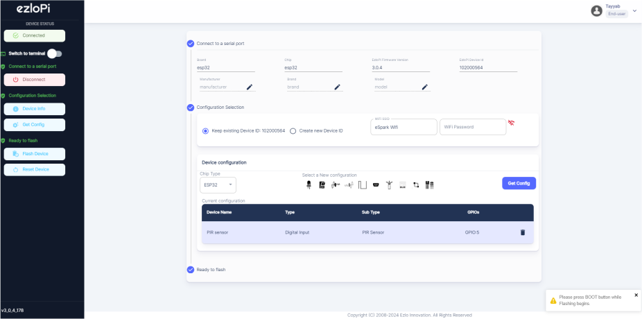

Set up your device/hardware by visiting config.ezlopi.com
Now, select COM Port to which your ESP32 device is connected. In our case, the COM3 port is used.
Click Connect.

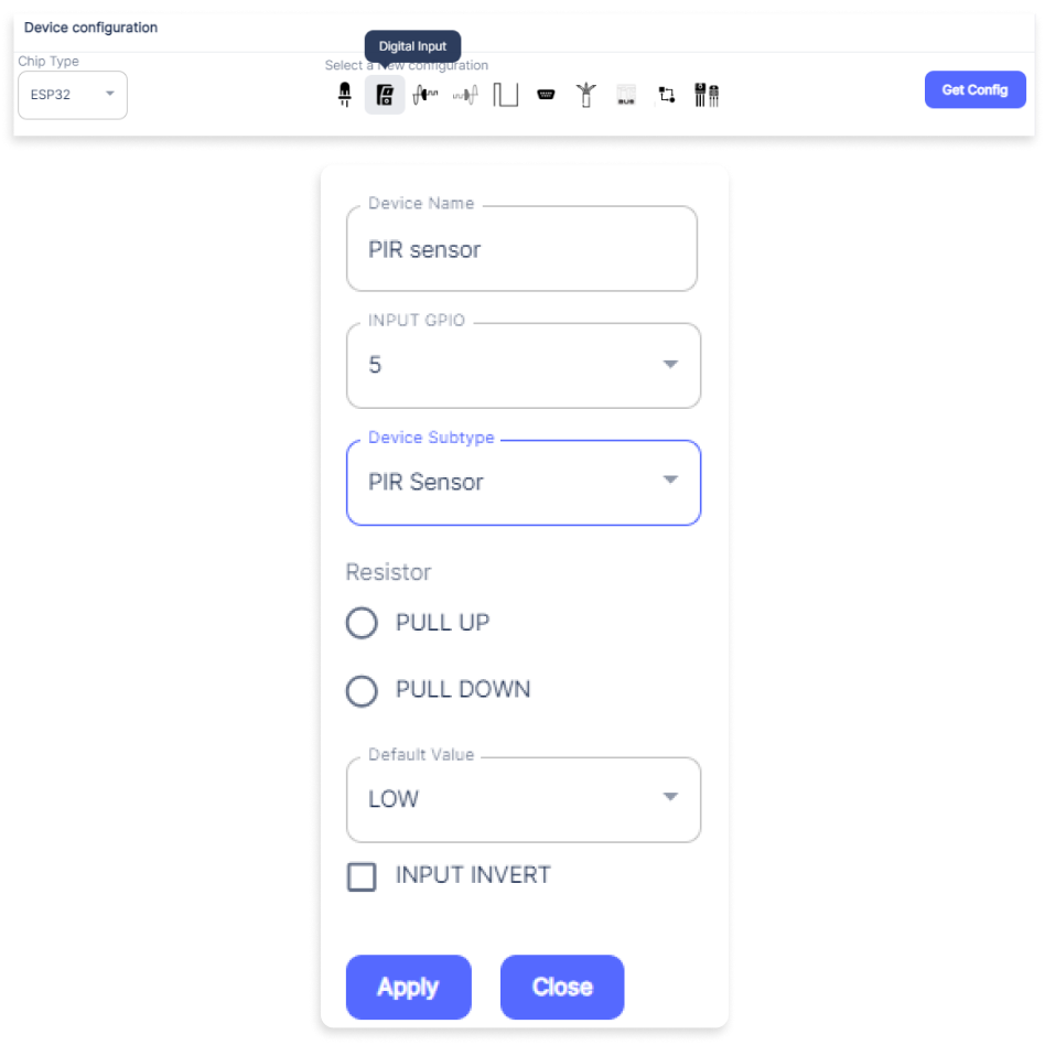

- A Digital Input window will open for inputting the following parameters:
- Set a device name of your choosing. In our case, we set it to PIR Sensor.
- Set OUT GPIO to 5.
- Set Device subtype to PIR Sensor.
- Then Click Apply Button.

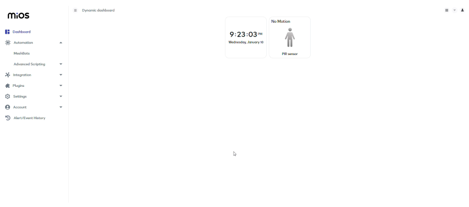

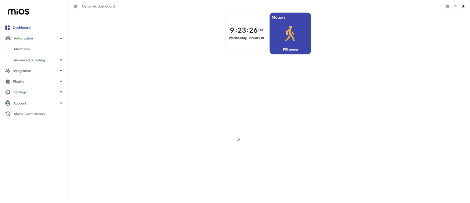

5. MiOS Web Application
- Here, as you can see in the MiOS web dashboard, we can see the motion sensor tile. The above figure is indicating that motion is not being detected by the sensor.

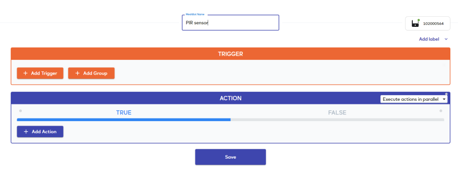

- On the right side of the screen under Automation, click on MeshBots.
- After clicking on Create new MeshBot you will see this now under Automation MeshBot click on Cloud.
- On the next screen you will see that we can create a name of our choosing, in this case we write it as Test003.

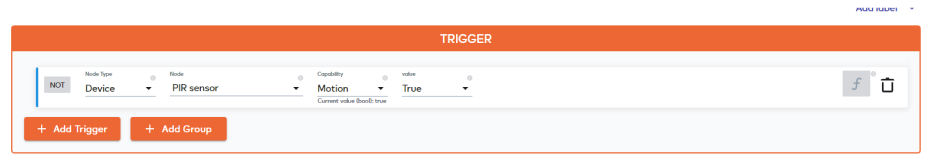

- Set Node Type to Device.
- Set the Node to PIR sensor.
- Set the Capability to Motion.
- Set the Value to True.

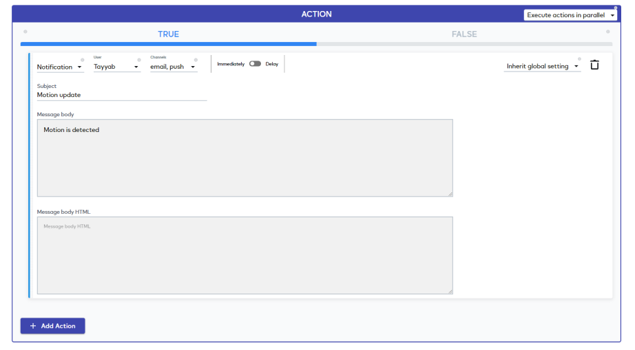

- Set these values in the ACTION section.
- Set Controllable Type to Notification.
- Set the User to Your user account but in our case the user account is Tayyab.
- Set the Channels to email,push.
- Set the Subject to Motion Update.
- Set the Message body info to Motion is detected.

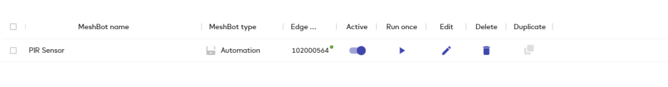

- After clicking the apply button you can see a table of your setting in the Current configuration tab.

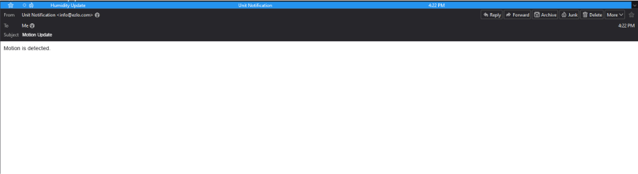

- The above figure is indicating that motion is being detected by the sensor. Therefore it automatically generates the email to notify the user.

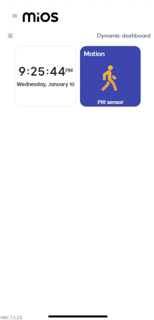

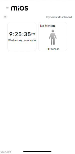

6. MiOS App
- Here, as you can see in the MiOS mobile app, we can see the motion sensor tile. The above figure is indicating that motion is not being detected by the sensor.
