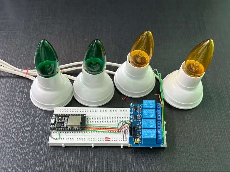

In this project, we will interface four different AC lamps with the EzloPi device using a 4-channel relay module which will perform as a switch. This will enable users to remotely control the four AC lamps using the MiOS smart application. This project combines hardware and software components to provide a user-friendly and easy-to-use solution for managing lighting in a smart home environment and ultimately enhancing the user experience and increasing energy efficiency.

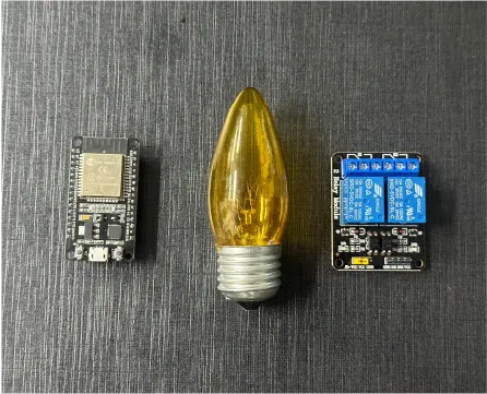

- 4-channel 5V Relay module.
- 4x AC lamps with holders and AC wires.

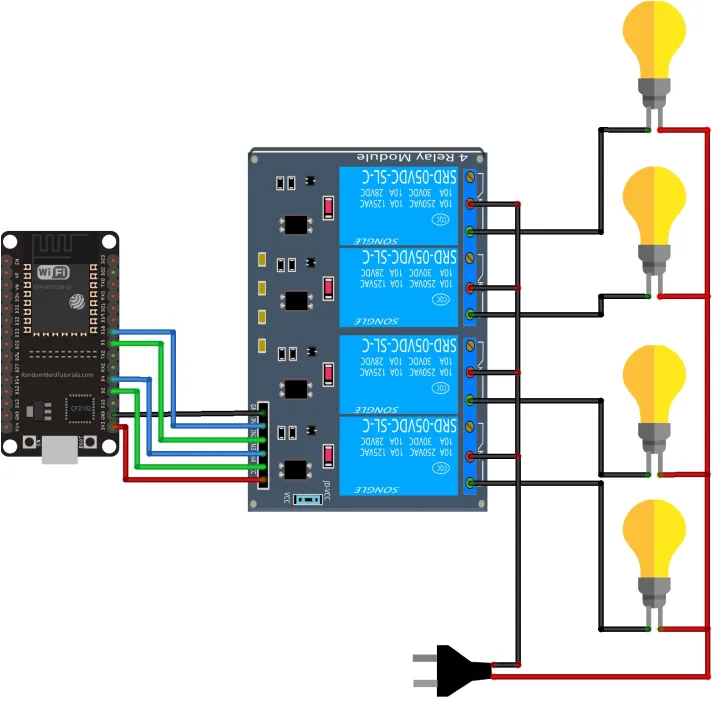

The wiring diagram for ESP32 is represented as below:
The following connections are made in order to complete the entire circuit setup:
From ESP32 to the Relay module:
- Connect the D18 pin from the ESP32 to the 1st channel of the relay module.
- Connect the D5 pin from the ESP32 to the 2nd channel of the relay module.
- Connect the D4 pin from the ESP32 to the 3rd channel of the relay module.
- Connect the D2 pin from the ESP32 to the 4th channel of the relay module.
- Connect the GND from the ESP32 to the GND of the relay module.
- Connect the ‘VCC’ terminal to 5V on the ESP32.
From Relay module to 220V AC Lamp:
- Connect the common of the relay module to the neutral.
- Connect the normally open point to the NO1 terminal of the 1st bulb, NO2 terminal of the 2nd bulb, NO3 terminal of the 3rd bulb, NO4 terminal of the 4th bulb and the second point of the bulbs will be connected to the phase voltages.

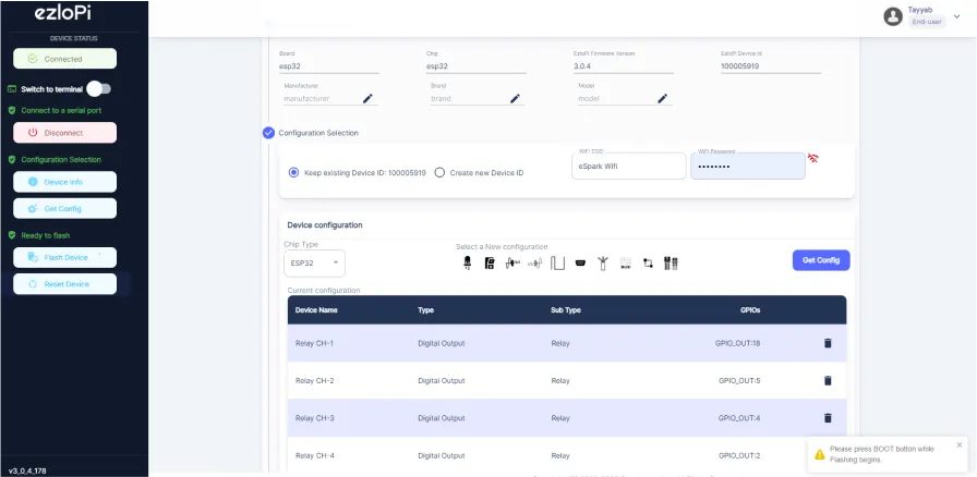

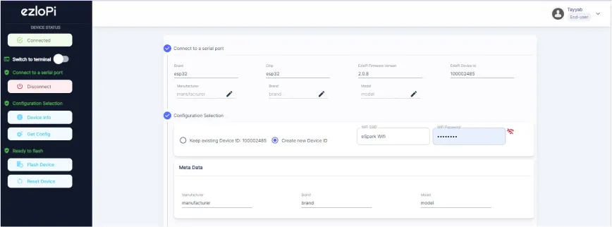

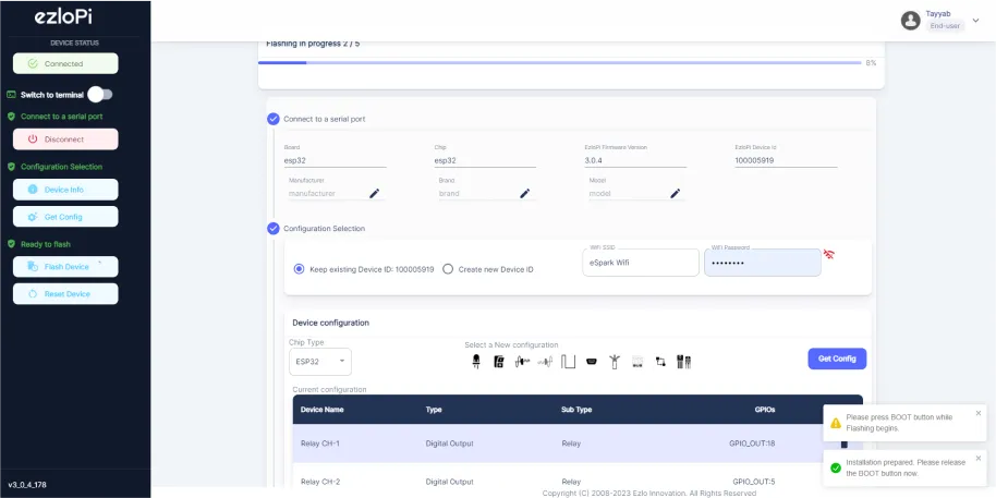

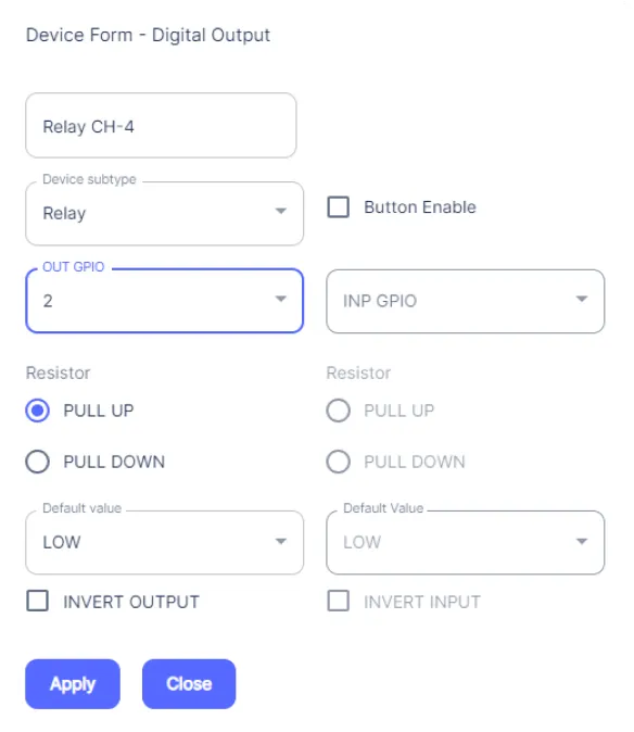

4. Interfacing the 4-channel relay module using the EzloPi Web Flasher:
Now, select COM Port to which your ESP32 device is connected. In our case, the COM3 port is used.
Click Connect.

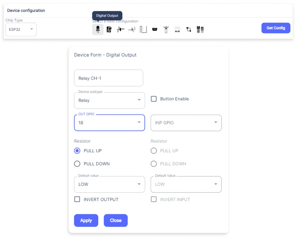

- Set device name to Relay CH-1.
- Set Device subtype to Relay.
- Set OUT GPIO to 18.
- Set Resistor to PULL UP.
- Set the default value to LOW.
- Now Click the Apply button.
- Again click on Digital Output.

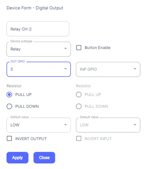

- Set device name to Relay CH-2.
- Set OUT GPIO to 5.
- Again click on Digital Output:

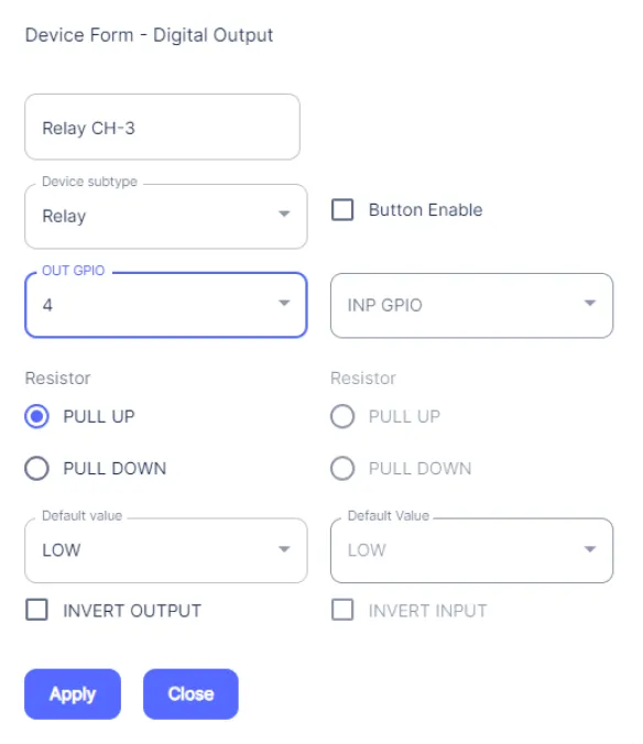

- Set device name to Relay CH-3.
- Set OUT GPIO to 4.

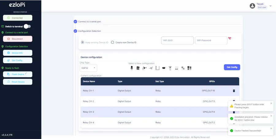

- Then again click on Digital Output:
- Set device name to Relay CH-4.
- Set OUT GPIO to 2.
- Then Click Apply Button.

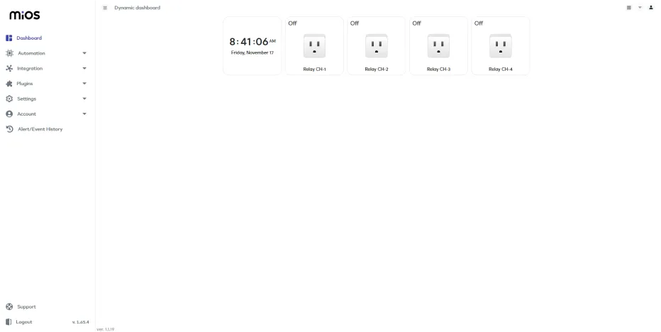

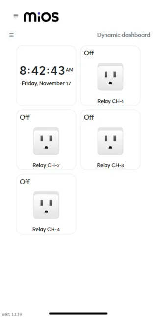

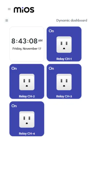

5. MiOS App
- After opening the MiOS mobile app dashboard, you will be able to see the tile of your connected device. The state of all the four AC lamps can be controlled by just touching on the tiles for the lamps connected to the relay modules.
- Currently, all the tiles for the relay are OFF, which indicates that all the AC lamps are OFF.
- Similarly, it can be seen that when all the relay modules are ON, it indicates that all four lamps are ON.

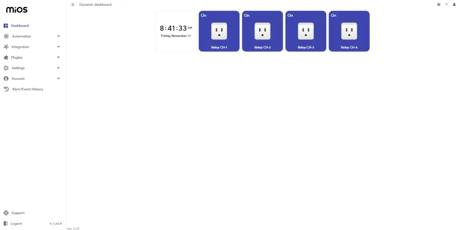

6. MiOS Web Application
- After opening the MiOS web dashboard, you will be able to see the tile of your connected device. The state of all the four AC lamps can be controlled by just touching on the tiles for the lamps connected to the relay modules.
